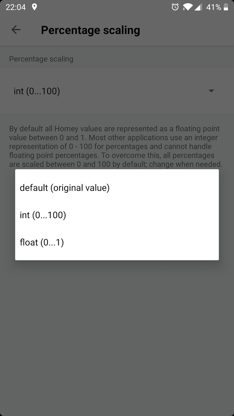

Submitted to store (beta channel; waiting for approval)
#### Version 2.2.5
- Added MQTT device setting to modify the `onoff` capability output (`true`/`false`, `on`/`off`, etc.)
- Cleanup MQTT Device topic settings
 ![image](https://us1.discourse-cdn.com/flex025/uploads/athom/original/2X/d/d89b3670abe1d96df5c5ea616cd57331197a8033.png) ![image](https://us1.discourse-cdn.com/flex025/uploads/athom/original/2X/1/13205e873097e9133e4b4e09cfd60657fd13da59.png) ![image](https://us1.discourse-cdn.com/flex025/uploads/athom/original/2X/2/2d1bc7c36d963c41871d98e2127c93cbde080aa5.jpeg) ![image](https://us1.discourse-cdn.com/flex025/uploads/athom/original/2X/7/71355d7d30ae90df04cd3f982004989de6046fe3.jpeg)
NOTE: Modifying topics should work. Adding/removing capabilities via devices settings is not possible, because the list of capabilities needs to be provided when installing the device…
