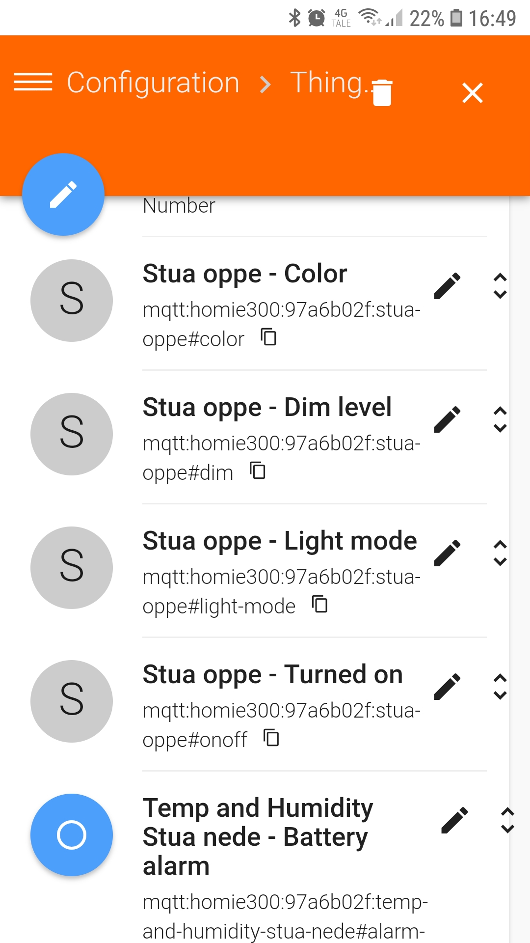

![Screenshot_20190207-164958_Chrome](https://us1.discourse-cdn.com/flex025/uploads/athom/original/2X/a/a7afbb2376d412185b7bb104772aa02fb619bfc1.jpeg)
Any ideas why I can’t add Hue lights? Same for fibaro dimmers.
