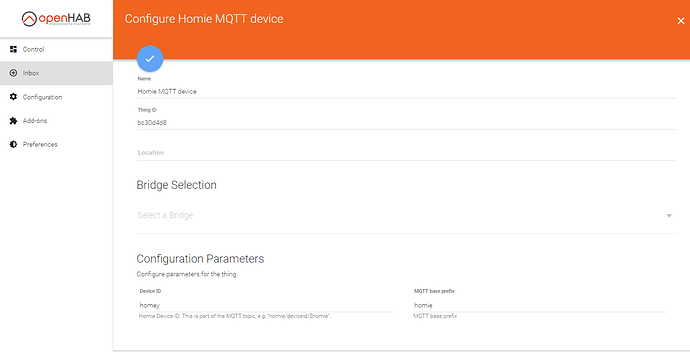

Can you also help on my second point:
1. MQTT-Explorer all comes in auto discover. How should the config look in OpenHAB, doesn’t work so far. So I installed
Bindings: MQTT binding.
Things: Homie MQTT device (this one is offline)
Things: MQTT Broker (online)

Try removing the OpenHAB MQTT Device & create a new one using the default settings.

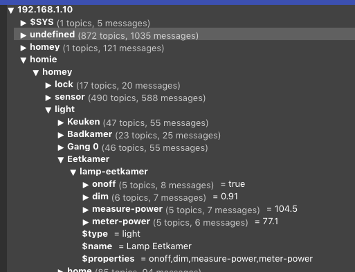

![1-MQTT%20Explorer](https://us1.discourse-cdn.com/flex025/uploads/athom/original/2X/8/8f1b4042d5b9451fde53942263fe84c47959d4e7.png)
MQEXPLORER still shows capitals n the names see Badkamer Eetkamer. Think this isn’t following the homie standard?

It shouldn’t. Going to look into that one.
I see you enabled the injection of the device class & zone into the topic. This breaks the Homie convention & will probably break auto discovery in openhab (it’s meant for custom usage in e.g. Node RED, I should probably document this)
