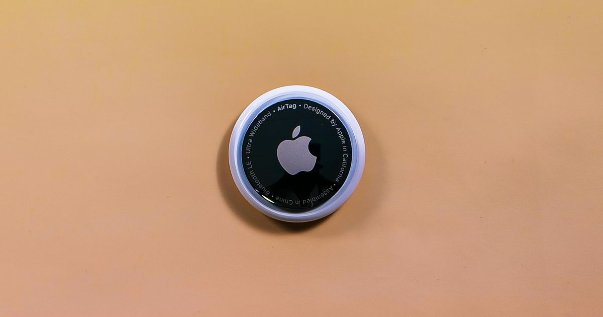

Disadvantage of the airtag: apple build in an algorith to prevent airtags to be used for tracking.
If an unknown airtag moves along with your iphone you get a message “airtag found moving with you”
So if the thief also has (or stole) an iphone, he will be alerted of the tracker
> **[Apple AirTags can be used to track you. Here's how to make that stop](https://www.cnet.com/tech/services-and-software/apple-airtags-can-be-used-to-track-you-heres-how-to-make-that-stop/)**
> AirTags can be used to stalk someone's location. Here are some tips for protecting yourself.

True, and at some point it also starts beeping (although there are [solutions for that](https://apple.stackexchange.com/a/419945) 😉 ).
