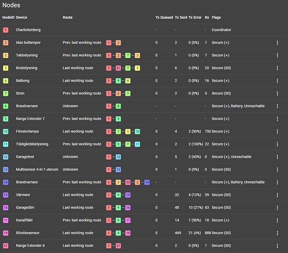

Now I have also put on a new antenna to extend the Z-wave range.
 ![Homey 210503](https://us1.discourse-cdn.com/flex025/uploads/athom/original/3X/3/a/3afe1efa8f5c4ceea08167e3a4ce7a8907fa7764.jpeg)
Without an extra antenna
 ![Homey 210506_lilla antennen](https://us1.discourse-cdn.com/flex025/uploads/athom/original/3X/2/b/2b0d96dfad9bfc0df4106fc29425138fa7dbefe0.jpeg)
With an antenna mounted on the case.
 ![Homey 210506_stora antennen](https://us1.discourse-cdn.com/flex025/uploads/athom/original/3X/8/5/85395b5e43106d2e8217def5f32d40a7b377889b.jpeg)
With an external antenna ouside the house.
The range is better, but the length of the cable on the external antenna counteracts an increase in power. The problem remains, however, that my Danalock V3 does not work reliably. It must have direct contact with the router. In my case, meshining takes place with two jumps.
I will leave my old Vera in the garage just to control the lock.
Now all that remains is to get my 433Mhz temp sensors to get in touch with the Homey.

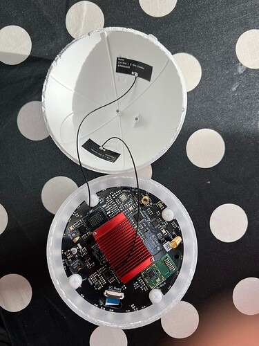

So I’ve got the aerials to have a go at the mod for Zigbee and Zwave. I’m pretty confident with the electronics part once I get inside the case, but I’m stuck at step 1! On my homey (pro 2019), there isn’t even a hair’s breadth gap anywhere around the case between the top and the plastic ring for the LEDs. I can’t even get the edge of a penknife blade in to get started. There’s plenty of gaps under the plastic ring where it looks like I might be able to lever the bottom off, but everything in this thread (I have read all 582 posts) says take the top off above the LED ring. So I have two questions and if anyone can offer suggestions I’d be extremely grateful:
1. Would trying to take the bottom of the case off _below_ the central ring for the LEDs be a really bad idea? It looks from some of the photos like there are 4 plastic screws that I’d end up trying to break without breaking the plastic ring itself. Anyone had any success with this method?
2. What were the original alternative steps that Johan did that were referenced above? The link to his website is still alive but I now can’t find any reference to this mod on his website.

> [@Jonathan\_Draper](#):
These are the openings of the IR diodes!
You have to open Homey above the IR ring. I had success back then using a watchmaker’s tool.
 ![20211106_112231](https://us1.discourse-cdn.com/flex025/uploads/athom/original/3X/2/3/23c422f20b130f3726bf7f0c05d38f4cca331464.jpeg)
But it is almost impossible to open Homey without a little damage to the edge. Open the back of Homey and you won’t see it. By opening above the IR ring, my plastic screws did not break off either. If it does, you can use superglue to fix the screws. The screws do not have to carry a high load.
 ![20211106_113114](https://us1.discourse-cdn.com/flex025/uploads/athom/original/3X/3/9/397e5d6df91c0c1814ec74c1407d8691bdc556a1.jpeg)
