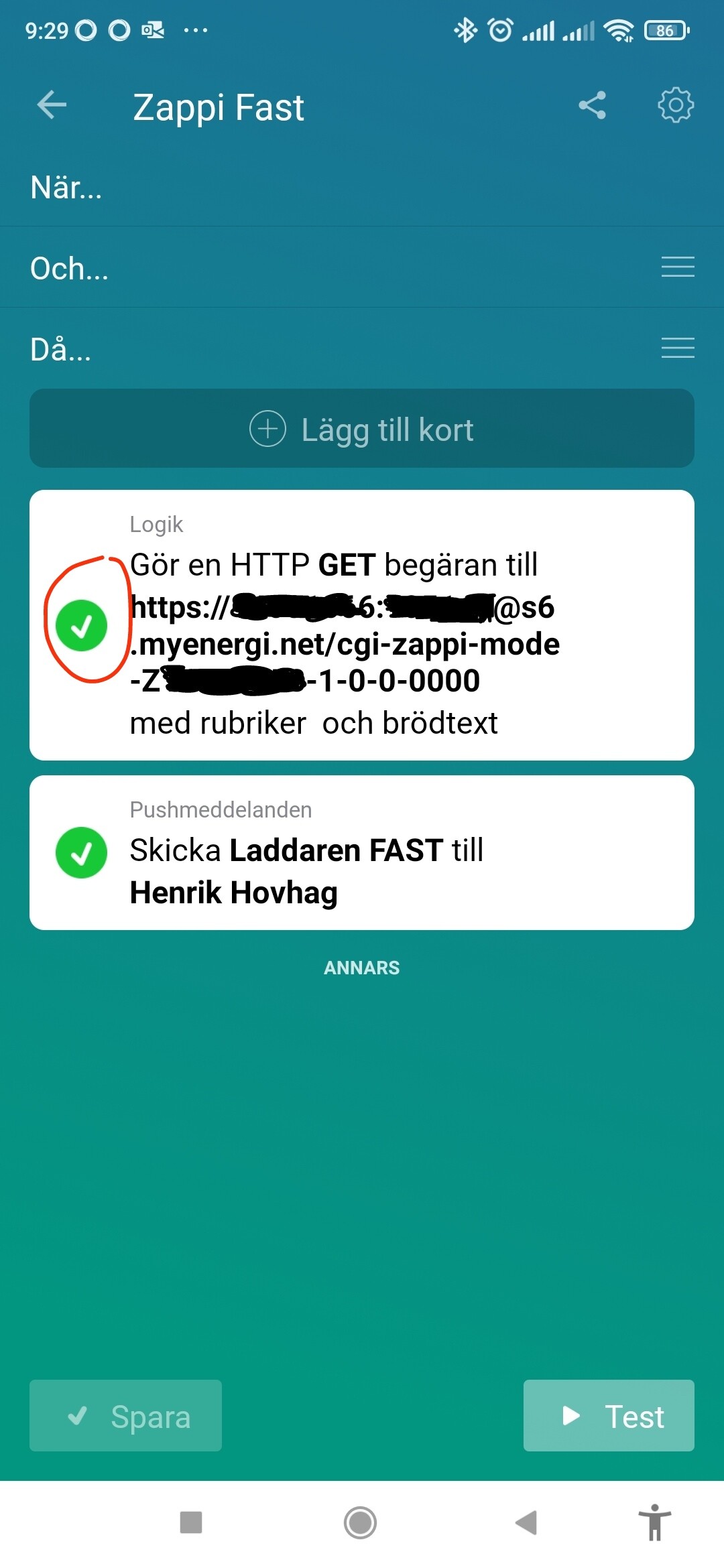

Hi.
I can not get webrequest to work.
I have a flow according to the picture, a fictitious switch is switched on when the electricity price is low and it is switched off when the price is high, this works. I then use this switch to trigger a new flow that will perform a webrequest, change a status in my ev charger (Zappi from MyEnergi)
If I type the URL in the browser’s address field, the change takes place in the ev charger, but when I trigger the flow, noting happens in my ev charger.
I use Method GET, because I have beeb told that it’s the same as when I enter the url in a web browser?
The address I want to send is: -[https://user:password@s6.myenergi.net/cgi-zappi-mode-Zserial-1-0-0-0000-](https://user:password@s6.myenergi.net/cgi-zappi-mode-Zserial-1-0-0-0000-)
I have tried both http and https.
I leave Headers and Body blank.
Anyone have an idea why it does not work?
Here is the api for myenergi. [GitHub - twonk/MyEnergi-App-Api: Investigation of the MyEnergi App](https://github.com/twonk/MyEnergi-App-Api)
 ![Skärmbild 2021-09-01 145225](https://us1.discourse-cdn.com/flex025/uploads/athom/original/3X/f/9/f9906a6a750f33c5602967a3466bb309ab82d464.png)

What happens when you press the “Test” button?

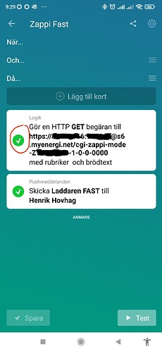

I get the green confirmation dot.
 ![IMG_20210902_093638](https://us1.discourse-cdn.com/flex025/uploads/athom/original/3X/a/0/a091d319ffada17fb8f2cec17c8ccd53e94b96eb.jpeg)
