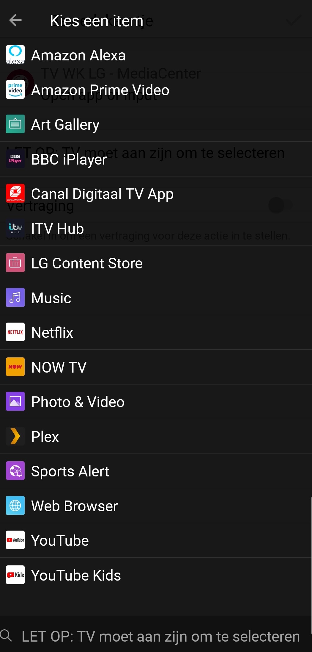

I am not able to set the input of my lg tv with webos 5.2.0 to a certain hdmi input. (Although I am able to set a certain app.) Who can help?
I see below option to add an action:
 ![Screenshot_20210309-201936_Homey](https://us1.discourse-cdn.com/flex025/uploads/athom/original/3X/1/8/1875e8937c687f72efb352d80087bdd2c77eb455.jpeg)
And after selection 'open app or input":
 ![SmartSelect_20210309-201843_Homey](https://us1.discourse-cdn.com/flex025/uploads/athom/original/3X/5/9/59bec0c5ce8efcda9275dbdef8d05bfe947e9941.jpeg)
And the pull down menu gives only app options, no inputs:
 ![SmartSelect_20210309-201818_Homey](https://us1.discourse-cdn.com/flex025/uploads/athom/original/3X/0/9/092f441c1f5ca28b1123af771047f7e4c70e85a0.jpeg)

Ok thanks for your answer. I was not aware it is a known issue. I understand you have different priorities.

Ah that would be nice if you can fix it. A suggestion from my side: if I can fill in the app-uri my self in stead of a selection menu I might be helped already.
I can easily retreive the uri, but I am not sure if calling this uri does the trick. See the screenshot
 ![SmartSelect_20210312-062815_Homey.jpg](https://us1.discourse-cdn.com/flex025/uploads/athom/original/3X/c/8/c8b19dcd1e83badb14cf4af2ba736b2cf7610adf.jpeg)
