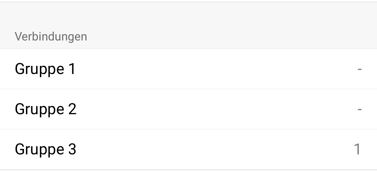

> [@JPe4619](#):
> I’ve never seen a “-” in Group 1, but if it works, let it work
 ![IMG_1800](https://us1.discourse-cdn.com/flex025/uploads/athom/original/3X/8/4/843d30769434f34cd35ce36d7e39a0c93f6b0d7a.jpeg)
Here Fibro FGS 212
A large number of Fibaro devices use Group 3 instead of Group 1 (Life Line), especially the older ones.
