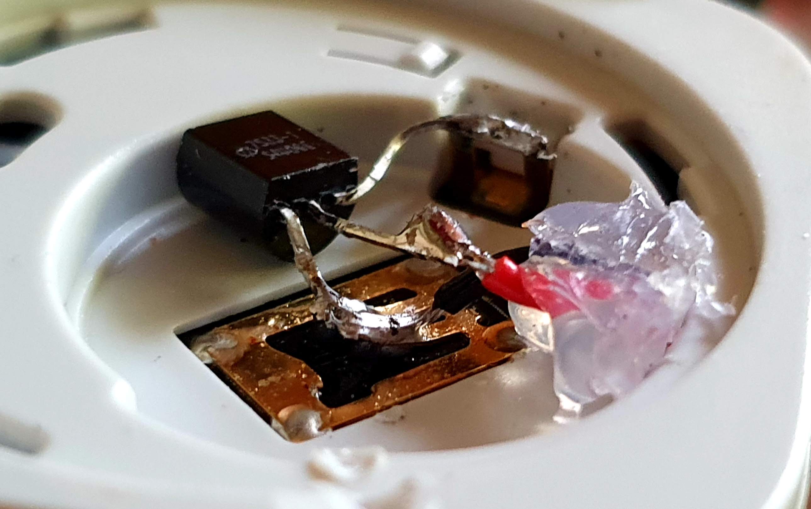

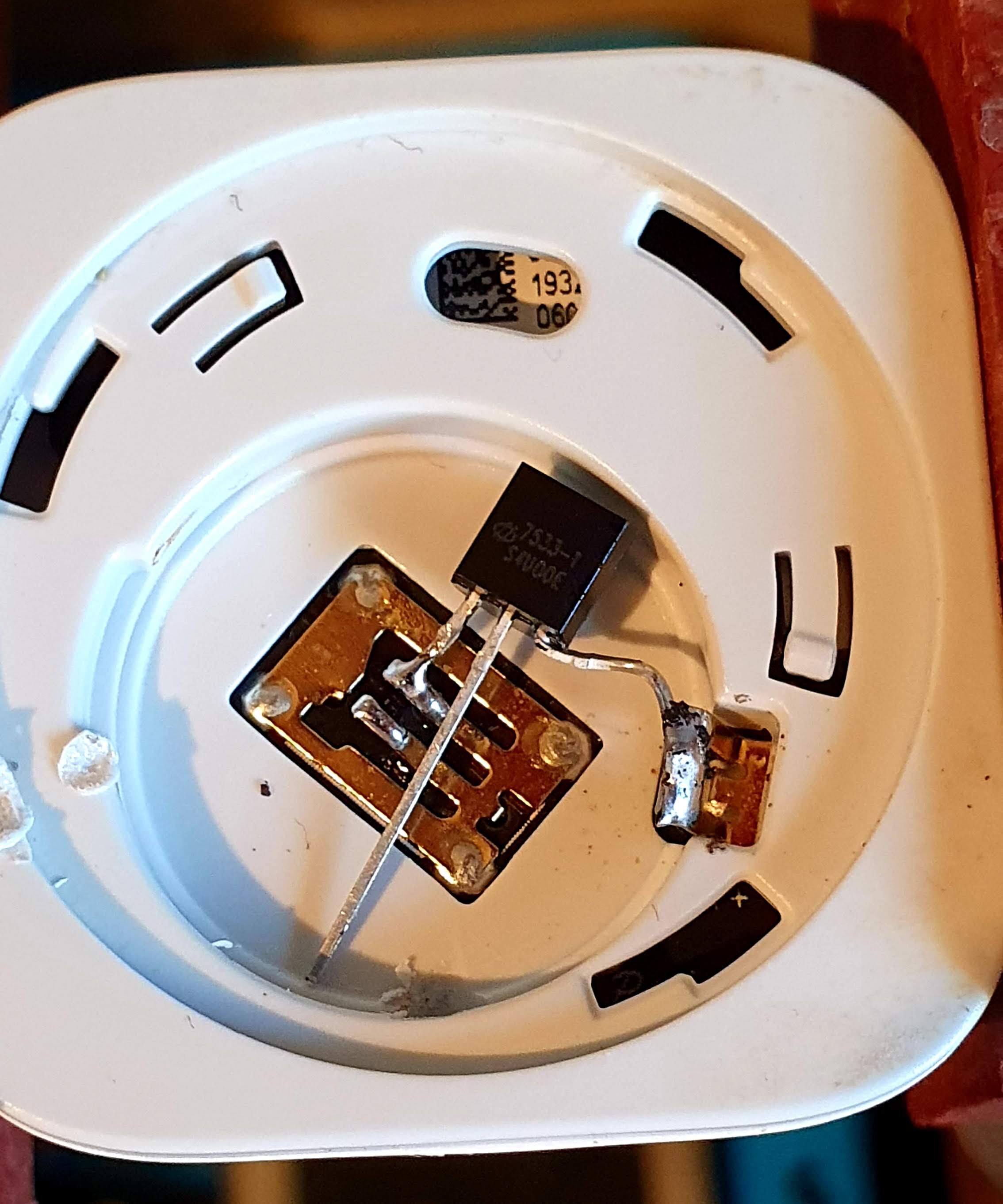

for a few years now i’ve been struggling with the Xiaomi sensors battery replacement and for this wanted a solution so that i’d never have to replace the battery’s again. with a little help i found what i was looking for.
first off i drilled a hole in de side of the casing:
 ![20210102_125515](https://us1.discourse-cdn.com/flex025/uploads/athom/original/3X/9/4/946c37fc9ba97abe5c9c5c4bdb8b1a8119564c4a.jpeg)
then i soldered the ground and the 3.3v output pin from a voltage reducer to the battery contacts: ![20210102_125607](https://us1.discourse-cdn.com/flex025/uploads/athom/original/3X/3/4/342bd6b2982a65b72a1d86d51a9677c2a505e555.jpeg)
Voltage reducer 4.5-24V to 3.3V : [Link](https://www.tinytronics.nl/shop/nl/componenten/spanningsregelaars/ht7533-1-3.3v-spanningsregelaar-to92)
then i hot glued the cable and connected the - to the - of the sensor: ![20210102_125652](https://us1.discourse-cdn.com/flex025/uploads/athom/original/3X/b/7/b75fdae31474ab3e5a36b46188ae1732817ee1b6.jpeg)
then solder the + from the usb cable to the imput of the reducer: ![20210102_125724](https://us1.discourse-cdn.com/flex025/uploads/athom/original/3X/0/7/0754f7afda522aa4a77938519589409342a67350.jpeg).
now connect the usb-cable to a wall-socket/power supply and press the connect button to see it work.
after this i used some UV-Resin to make sure the cables are not connecting when something moves(few drops) and UV glued the cable to the side of the case: ![20210102_125335](https://us1.discourse-cdn.com/flex025/uploads/athom/original/3X/4/7/475e23d9cdd015daeb696ad368a16e5670e132ec.jpeg)
this way the battery lid can still be closed, the unit will never go into power-save, will never disconnect and reports to homey correctly.

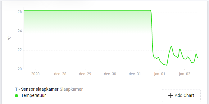

it doesnt 🙂 but since the voltage is always 3.3v and never drops the unit beleaves the battery is always 100%
