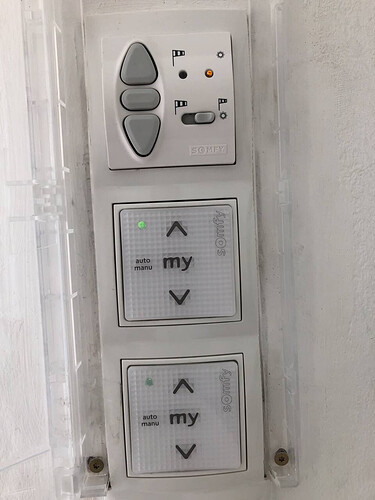

I was wondering if I can get my **two awnings** into Homey via some particular switches. Currently they’re hardwired and controlled either manually or via two sensors (wind or wind and lux)
These are the controllers (Somfy). The upper one controls the sensors and both awnings. The other two are for each respective awning to control it manually and independently.
 ![image](https://us1.discourse-cdn.com/flex025/uploads/athom/original/3X/3/d/3dd8592a9bd980a2e7d9556f4bf5f6bb66112ce0.jpeg)
And advice what would work here?

I’m not sure, but it looks like those bottom two might actually be wireless RTS switches rather than hardwired ones. If so, you’d be able to copy the signal using the Somfy RTS app on Homey and control the awning that way.
If it _is_ fully hardwired, then using something like a Shelly 2.5 or the aforementioned Fibaro would be the best solution.

everything is hardwired I checked with the guy who set this up.
There’s one questions that bothers me: How can I keep the current sensor actions “wind” and “light”, they are linked to the topmost switch and move both awnings.
Ideally I’m able to switch these also remotely. If this is not possible I will need to have an additional light sensor, the wind sensor is a perfect backup anyway.
**Most important** : I’d like to keep the switches but this should be doable w/ Fibaro/Shelly, right?

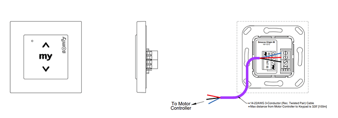

you mean to connect a smart switch (Fibaro/Shelly) to the sensors switch?
I thought to just use the wired sensors as a security backup for the wind and use the 2 Smooves underneath plus a light sensor to actually drive the two awnings, this way I can drive them separately. Does this make sense?
That’s the diagram for the Smoove, what do you think?
 ![image](https://us1.discourse-cdn.com/flex025/uploads/athom/original/3X/2/f/2fc31972778a04df9ee7384eba0bd64e692bf0ac.png)
[Details](https://asset.somfy.com/Document/1ae0eb8b-f9b4-40bf-ba20-753cf4742e64_smoove-origin_IB_Installation_Instructions.pdf)

sorry for being ambiguous. there are 3 switches. the top switch is connected to the sensors. the 2 underneath are not, they operate the awnings independently. After pondering with what you suggested I thought it’s easier and more flexible to automate the two switches and leave the top switch as is and as an automatic back up for high wind pullback. Makes sense?
 ![image](https://us1.discourse-cdn.com/flex025/uploads/athom/original/3X/e/d/ede5a3576e642adddf12e238f2cc01d3b809b868.jpeg)
