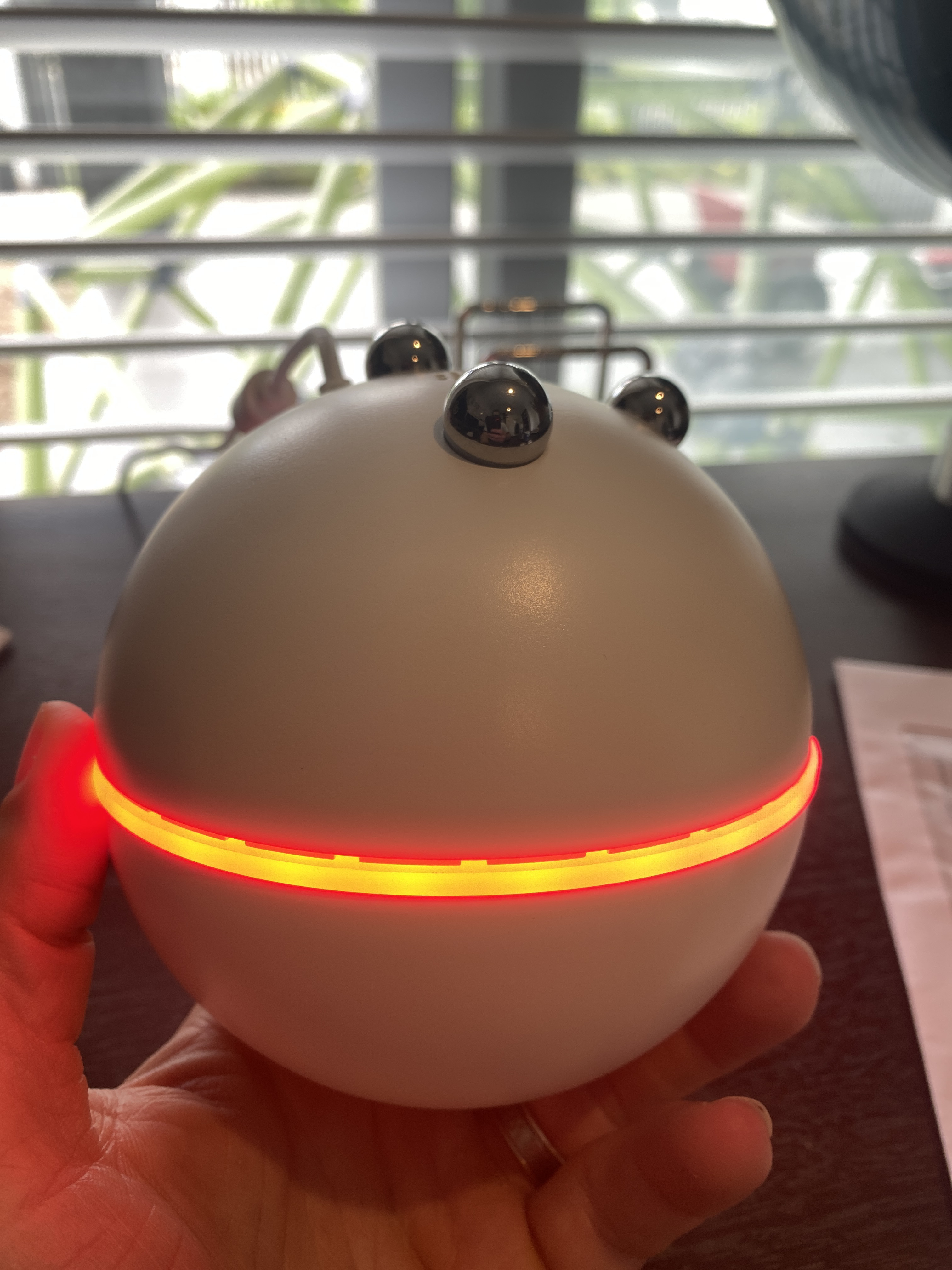

I woke up to dead homey this morning. Can assume it updated to v5.0 overnight. Looking for way to recover, currently reviewing support material. Worst case I pray the overnight back service can restore my unit - hopefully upgrade incorporated final version backup
 ![image](https://us1.discourse-cdn.com/flex025/uploads/athom/original/3X/d/2/d2cc872db52f30136efc4b6e313f95b58eaac735.jpeg) ![image](https://us1.discourse-cdn.com/flex025/uploads/athom/original/3X/9/c/9c60950cd8ceae032663e78280503149b4c24f25.jpeg)
Any guidance recommend?

> [@PJ-AU](#):
Try a PtP [[HOW TO] ptp](https://community.homey.app/t/how-to-ptp/17304)
and try replace the USB Adapter for an other 2 Amp (2000mA) 5Volt Adapter (see the other issues about it [Search results for 'USB Power 2A ' - Homey Community Forum](https://community.homey.app/search?q=USB%20Power%202A%20))

Thanks @Dijker … no luck PTP or new PSU. Tried a few Apple 2 amp plugs. Reset process doesn’t have voice either. (Sigh) Analogous to the Xbox 360 Red Ring of Death! (RROD)
Spinning yellow, then red.

Only option imho Contact Athom support directly

I am hoping this can be fixed remotely as I don’t want to wait through RMA process. It was working rock solid for almost 18 months until the 5.0 bricked it.
