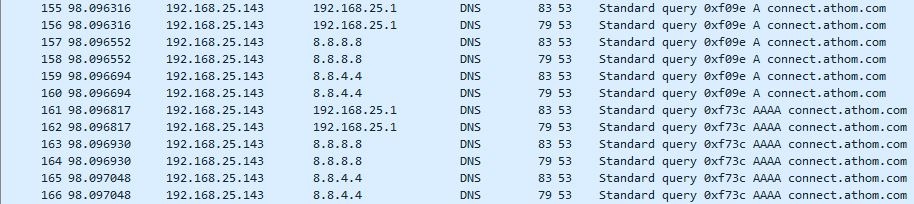

I was geeking around on my router a bit and I suddenly noticed that Homey tries to resolve all DNS-queries through the Google DNS-servers whereas my DHCP-server suggests all devices to use my router as it’s DNS-server.
Does anyone by any chance know why Homey would use the Google DNS servers rather than the one I want I want to use? ( I haven’t sent an e-mail to support yet. I didn’t want to bother them if someone else over here knows why 🙂 )
 ![Homey-DNS](https://us1.discourse-cdn.com/flex025/uploads/athom/original/3X/7/4/74e15763e5a75ce26b3abb075ce31554ec8af5cc.jpeg)

> [@anon8748058](#):
Yes, Homey uses hardcoded Google DNS servers. I believe the reason for this was that users cannot be trusted to set correct DNS servers in their router (if they actually do so; most don’t, would be my guess), which could break Homey’s functionality (and cause more support requests for Athom).

I have set a number of firewall rules on my router that redirects any DNS-request that is not going towards my own DNS-server, except for the ones coming from my own DNS-server to my own DNS-server.
(( small detail in case you care, my own DNS-server uses DoH towards Cloudflare ))
This basically means that the Google DNS-servers can’t be faster in any case as in the end, they are always forwarded to my own DNS-server.
It’s always strange to see that it always sends all DNS-queries to my own DNS server and Google’s DNS server after 1-2 microseconds (so basically at the same time)

> [@anon8748058](#):
That’s exactly the flaw I showed Athom, they say homey only uses google dns when the internal dns doesn’t answer, but that’s not true. Your situation is more proof of homey not doing what they say it does.

It also looks like it’s sending two A queries to each Google server.

Yes, I saw that too in my testing, multiple request.

Not sure what the “83 53” and “79 53” numbers are, but those differ for each request. I assume the last number (53) is the target port on the nameserver, but 83/79 seem strange for source ports.

The 83 and 79 are the package-length (bytes)
