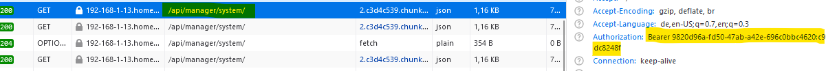

I bumped into a problem though, that I can’t seem to figure out. When I’ve added the cloudID and the auth token I get the message “Set app settings” when I open the app on my Garmin Fenix 6 Sapphire, I can also go to Devices and Flows, but they both state 0. I tried adding the “Bearer” in front of the token, but then it just stated that the session expired, so I assume that not having the “Bearer” in front was correct?

You have to copy the whole value. Here is a screenshot from Firefox:
 ![grafik](https://us1.discourse-cdn.com/flex025/uploads/athom/original/3X/a/f/af3a0dc3a34fdb29b4ea856a96d15bf83cb919a3.png)
Best way to find the needed http call ist to search for file “/api/manager/system/”. That are API calls where the toke is used.
You have to copy the whole value after “Authorization” including the "Bearer ". It can happen, that the string is displayed with a linebreak if the window is too small. Don’t miss this part.

Coped again and now it works 😀
