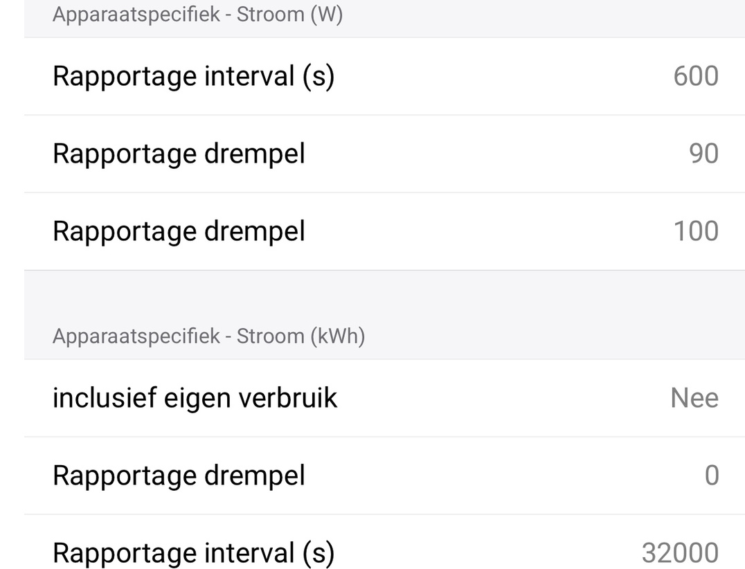

Of course it depends on the type of module.
These settings stop a Dimmer2 from sending power figures:
 ![image](https://us1.discourse-cdn.com/flex025/uploads/athom/original/2X/f/f03b26a3d6bd28954044152d0d91d687d12b25d5.png)
And these settings limit the number of figures from a wall plug switch:
 ![image](https://us1.discourse-cdn.com/flex025/uploads/athom/original/2X/b/b72429821339d8fedb018d21f8416ece784ac600.jpeg)
You need to tweak these settings until you receive just enough info for your use case. In my case, I just want to know if my coffee machine is off, idle, or brewing. When it is idle, the power usage fluctuates and that is what I largely filter out with these settings.
