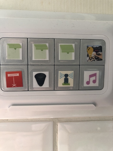

I use a remotec 8 button switch. Even wife and children get the point
 ![image](https://us1.discourse-cdn.com/flex025/uploads/athom/original/3X/6/d/6d93bf95b1e9b152a91d402bde75ed838e7fc583.jpeg)
