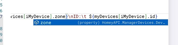

I see that i .zoneName is not avalable, but
 ![image](https://us1.discourse-cdn.com/flex025/uploads/athom/original/3X/b/1/b173fd5d975d062990b16dd014b3a8d3ee9f70d2.png)
.zone is (returns the zone’s ID)
Thanks again, Peter\_Kawa. Another tool in the box 🙂 👍

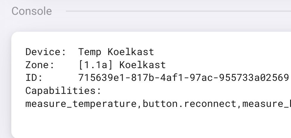

 ![Screenshot_20230929-143658_Firefox](https://us1.discourse-cdn.com/flex025/uploads/athom/original/3X/1/5/15488f629cf928d81fc0f3f2aee571a0d02393c5.jpeg)
but, on my Pro2019 it returns the zone name anyways when i use i.zoneName 😊

And YW.
