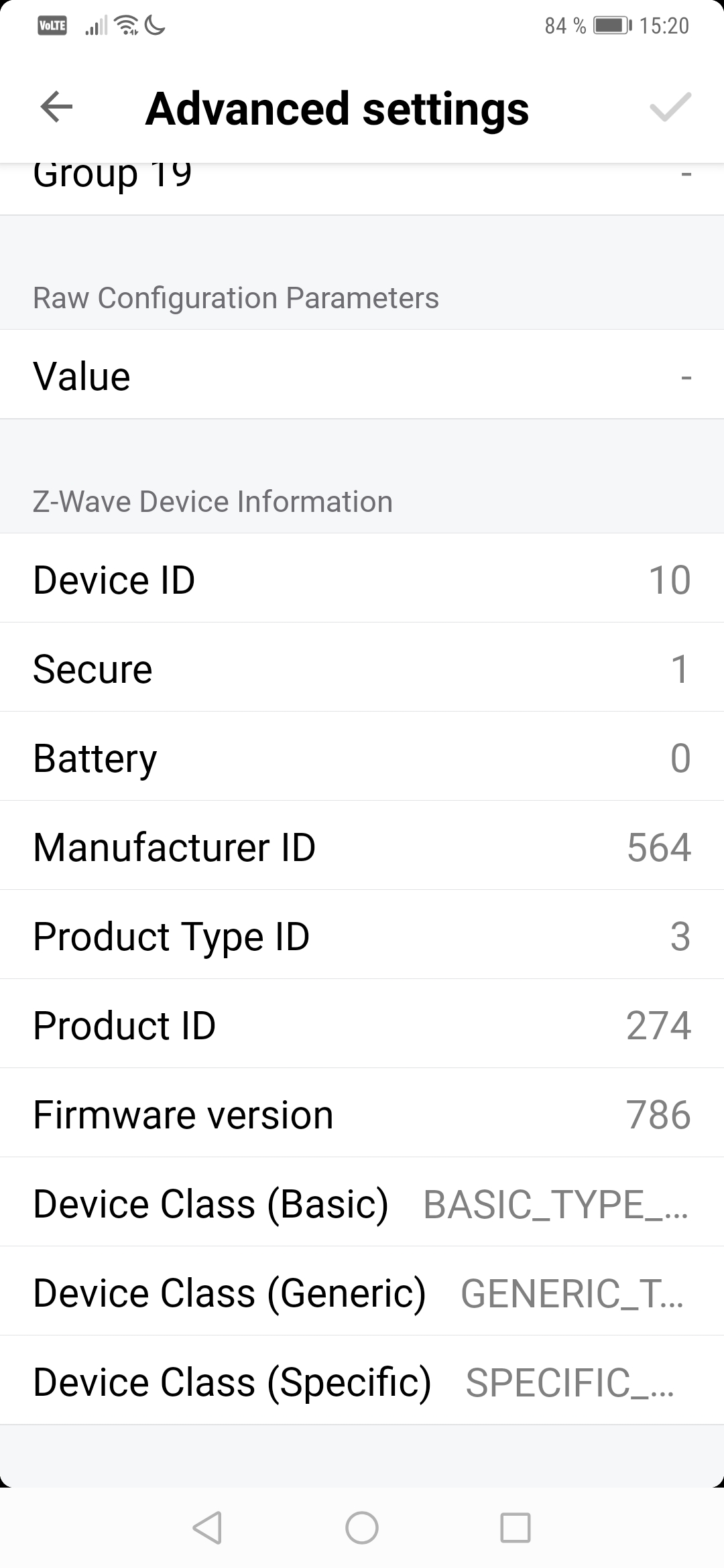

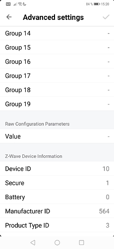

Manufacturer ID = 564
Product type ID = 3
Product ID = 274
I have also uploaded 3 screenshots with the complete advanced settings from the included z-din. The device is essentially 6 relays in 1 device. There is no usage monitoring… Tell me if I can supply more information
 ![homey](https://us1.discourse-cdn.com/flex025/uploads/athom/original/2X/3/3c0e01c79d47f8061fc008aad751fd3d72b5624e.jpeg) ![homey](https://us1.discourse-cdn.com/flex025/uploads/athom/original/2X/4/4b2323851d5e154615bd829142bc9803c4e17ef9.jpeg) ![homey](https://us1.discourse-cdn.com/flex025/uploads/athom/original/2X/e/eb1d3fb37adb8660389c22aa4aeec72479e0b8c9.jpeg)

> [@csaether](#):
> Product type ID = 3
> Product ID = 274
Thanks, just to be sure… this is a Heatit branded version or a Logic Home Control branded version?
The Manufacturer ID (564) refers to Logic Home Control and not Heatit (411).

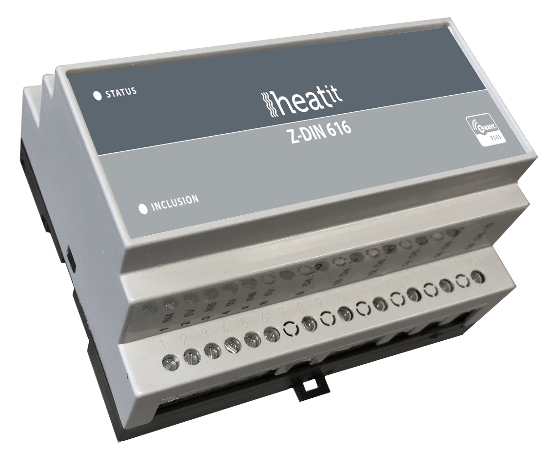

The version i have is defenetly heatit branded (se enclosed picture). But after your information I have looked at the Logic website (I had never heard of this brand before), and downloaded the user manual. I am now quite convinced that the product is actually a Logic product with heatit stickers. I actually think this might be the case for all the Heatit z-wave products except for the thermostats… I looks to me that you have also created an app for Logic products, I presume it would make more sense to add this product there under its logic name (ZIF5028). Again, please let me know if i can be of any assistance in researching or providing information that might help! ![Heatit-Z-DIN-616](https://us1.discourse-cdn.com/flex025/uploads/athom/original/2X/8/86218af69a20facce8ee9d32d64c048b3811d5c0.jpeg)

@csaether Yes, I’m developing both apps and was aware of the rebranding.
I’m clairfying with Logic Group development is accidently the incorrect manufacturer ID is used or not.
The Z-water and ZIF5031 do use the same product(Type)ID’s and different manufacturer ID’s.
