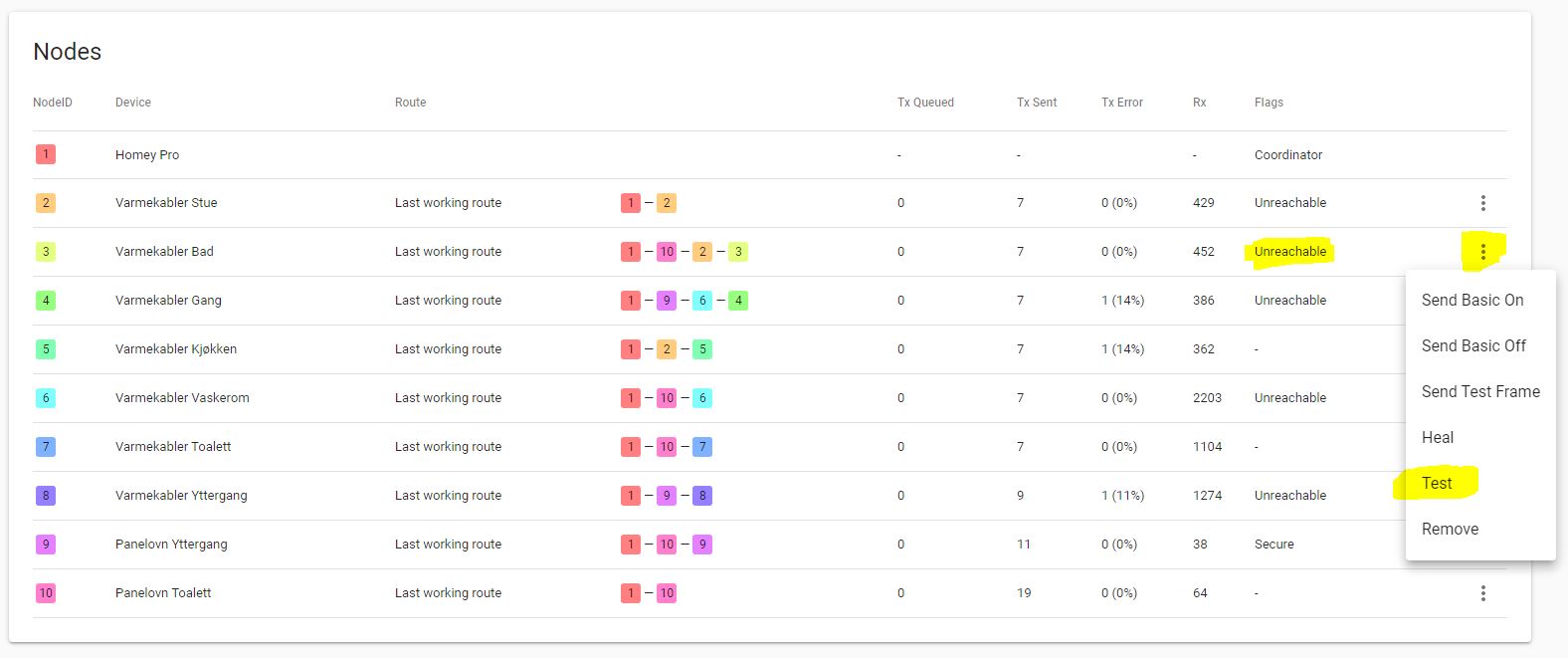

I have several Z-TRM2fx devices for controlling floor heating in my home. I have issues getting Homey Heating Scheduler to set all the thermostats as scheduled. Sometimes it works and sometimes not.
I have done a lot of digging to find out why this was not working and I think I found the reason.
It seems that Homey very often believes that one or more of my Z-TRM2fx devices are unreachable. This in turn seem to mess up the z-wave routing resulting very bad / long routes.
I’m not sure how Homey handles communication with unreachable devices, but maybe it just skips sending the commands.
I think it is the Heatit z-wave driver that reports (or not reporting) the z-wave device statuses to Homey. I never had any issues controlling the thermostats from the device pane in the Homey app, so I suspect the devices are in fact communicating properly even if Homey believes they are not.
 ![Z-Wave routing](https://us1.discourse-cdn.com/flex025/uploads/athom/original/3X/d/c/dcd6e677b115e3198c154c8a02bba1297337b486.jpeg)
Node 2 – 8 are Z-TRM2fx devices. 9 and 10 are two different Fibaro devices. If I do a test on an unreachable device, it reports OK and the unreachable flag is removed. After a while the flag is set again. The Fibaro devices are never flagged as unreachable.
Can you please have a look into this?
I’ll be happy to provide you with more info if necessary.
Rgds.
Jan Olav

Homey is saying the same at my end, that they are unreachable. However I am not having any problems with flows what so ever. If I click heal it will tell me it is reachable but after a while it will change back to unreachable.
 ![image](https://us1.discourse-cdn.com/flex025/uploads/athom/original/3X/2/1/21d29ed33c382fe852bd0713b82900458df27b2c.png)

What’s the name of this z-wave debug tool?

Just type [developer.athom.com](http://developer.athom.com) and login with your homey account.

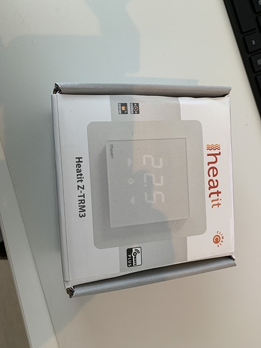

![image](https://us1.discourse-cdn.com/flex025/uploads/athom/original/3X/b/3/b3b7b6b3ea2ce89d008dabbfab3f70dba245a581.jpeg)
Now waiting for support of the HomeyApp 😉 (thanks for the great work again @TedTolboom)
