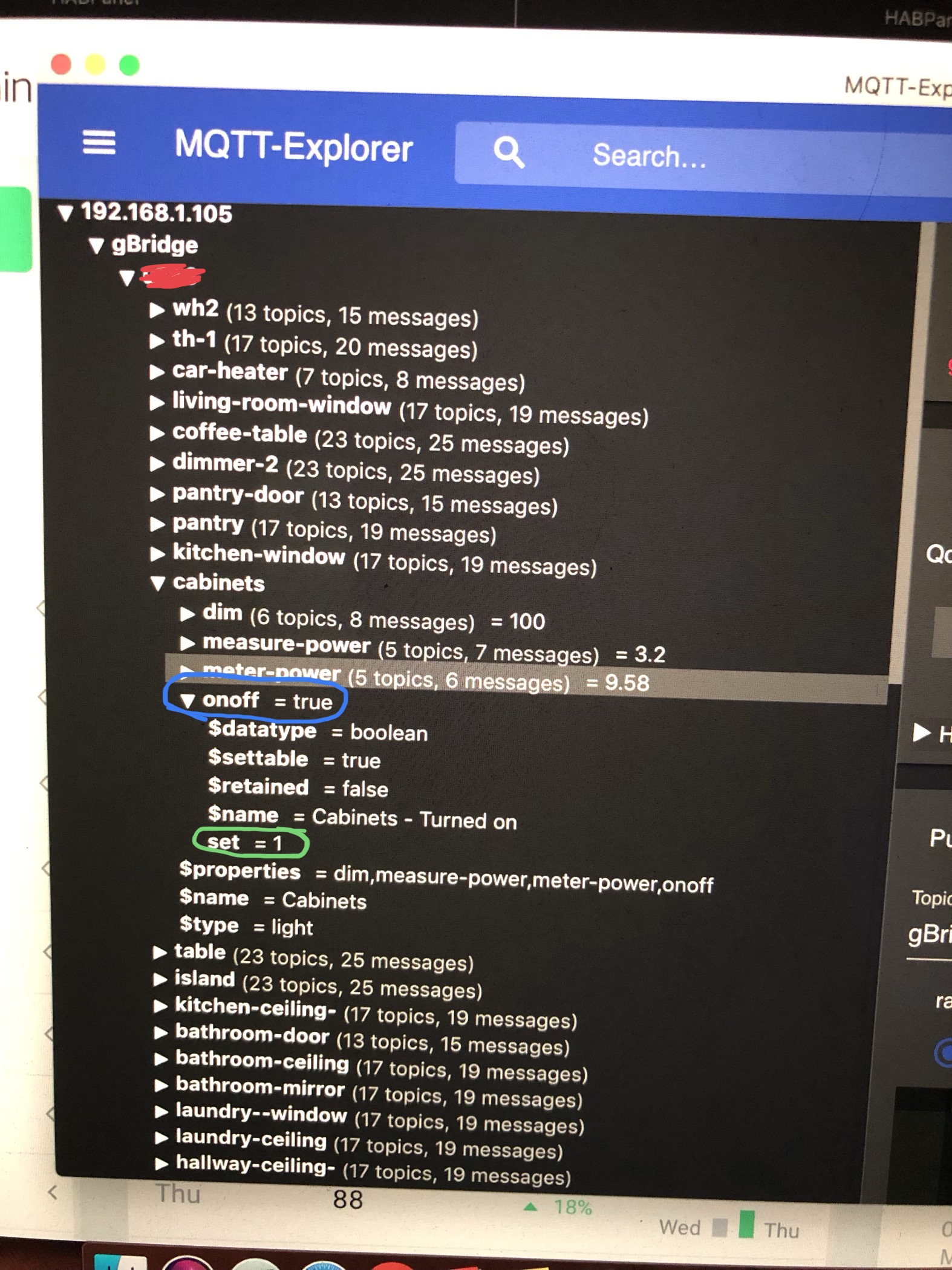

I’m not that familiar with the logs but from what I can tell they seem correct.
I think your MQTT Explorer looks correct, since you’ve told Homey to use gBridge as root topic there shouldn’t be anything else there.
But try to expand the view to the device you are using. Make it look like the picture I attach here:
 ![image](https://us1.discourse-cdn.com/flex025/uploads/athom/original/2X/6/6b317649446c6601fa33d3802b1f896a42f5828b.jpeg)
When you turn the device on and off through Homey the value marked with blue should change between True and False.
When you turn the device on and off through Google Home the value marked green should change between 1 and 0. (If everything works correctly Homey notices this and also turns the device on/off and the blue value also changes)
Check if both these conditions are true.

Thanks for helping out. When switching from Homey the ‘onoff’ value indeed changes from false to true and back again. When switching from Google Home, the ‘set’ value changes between 0 and 1, but the ‘onoff’ value isn’t updated with it.
So if I understand correctly, the following should happen
- gBridge sets the ‘set’ value to 1 (on) or 0 (off)
- Homey sees this change, and is triggered to set the ‘onoff’ value to true (1) or false (0)
The second part is not happening. For some reason Homey is only sending out MQTT-packets, but not monitoring packets to use as input.

What happens if you publish ‘true’ or ‘false’ on the set topic using MQTT explorer?
<div class="post-metadata">
**Author:** ![Wout\_F](https://sea1.discourse-cdn.com/flex025/user_avatar/community.homey.app/wout_f/32/7474_2.png) [@Wout\_F](https://community.homey.app/u/Wout_F)\
**Post date:** [February 21, 2019, 7:00am UTC](https://community.homey.app/t/guide-to-connecting-gbridge-to-homey-for-google-assistant/9234/24 "2019-02-21T07:00:59Z")
</div>
Nothing, ‘onoff’ stays the same. Even when I manually set ‘onoff’ to ‘false’ , the light stays on. Homey seems to just not monitor any of those values.
