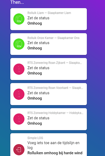

I want was working on a rule for my roller/shutters. When the wind is above 50 km/h then they will go up.
This is my flow:
 ![image](https://us1.discourse-cdn.com/flex025/uploads/athom/original/2X/7/7c32a8a59f0072b476743eba327387fb8a27b817.jpeg)
 ![image](https://us1.discourse-cdn.com/flex025/uploads/athom/original/2X/c/cf9da8723fb121f28459b65bcbd5d0558db30b74.png)
but now it’s triggered continue when the wind is above 50 km/s. How can I check the state of the roller/shutters, that if they are up the flow stops.
