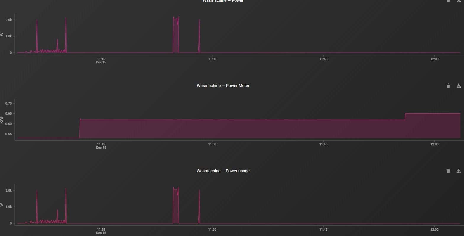

Hi, I have multiple brands of wallplugs, but with all of them, my washing machine shuts down the plug attached. The Fibaro, being the most expensive, should be able to handle it. There are loads of people with Fibaro plus and high output devices attached. According to insights, it peaks just a litte above 2kW. Is there something I can do in advanced settings to prevent it from shutting down on me?

my washing machine does the same with fibaro, probably because of the short +/-6x peak at the start of the motor spinning (probably even higher peak because of the water in it) raising the amperage just above the max of 11A (2500W) that it can handle, you won’t see this in insights as it is just a few ms (milliseconds)
i fixed by using an qubino plug which can handle 16A (3600W) and that keeps working reliable, it is a bit more bulky though
