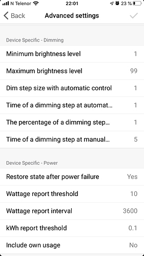

If you go on the settings inside homey on your dimmer 2 u can find the adjustment as u see on the top of my picture.

Thanks , I changed the brightness limits and indeed it is much better to control.
