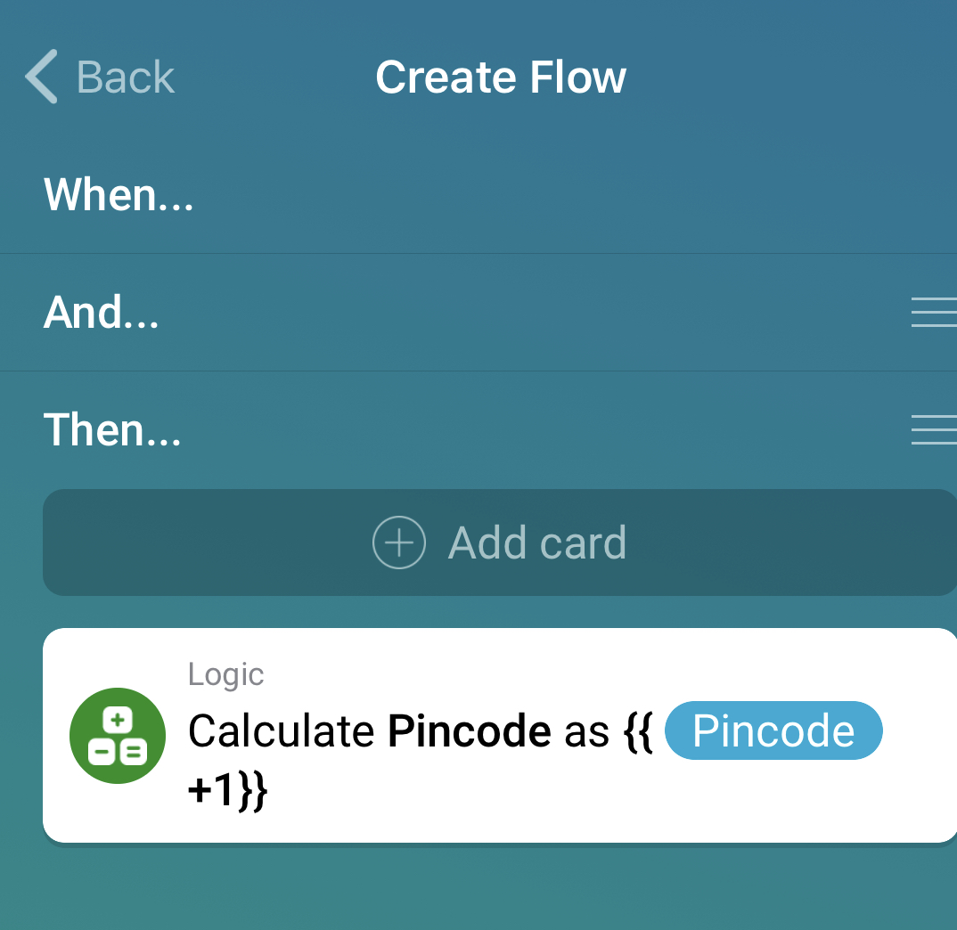

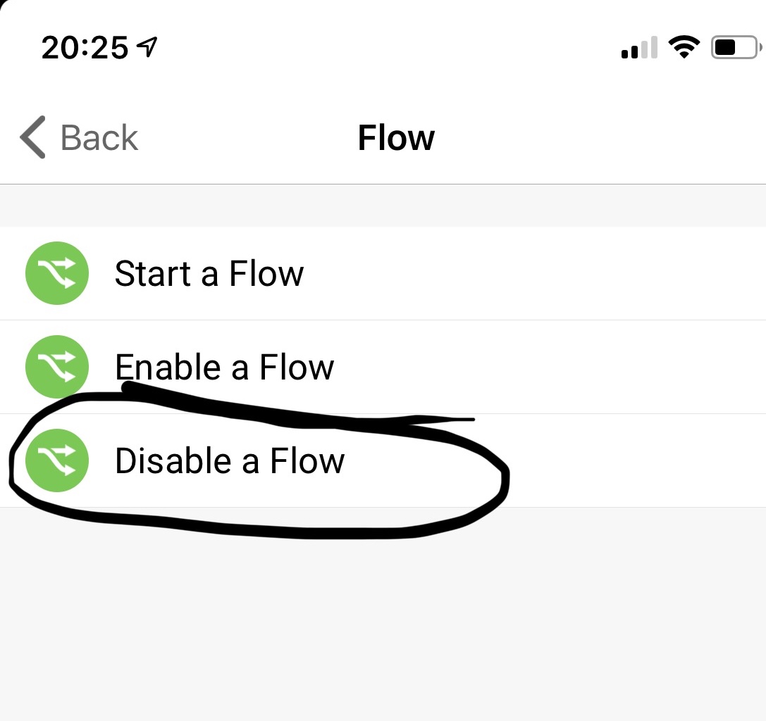

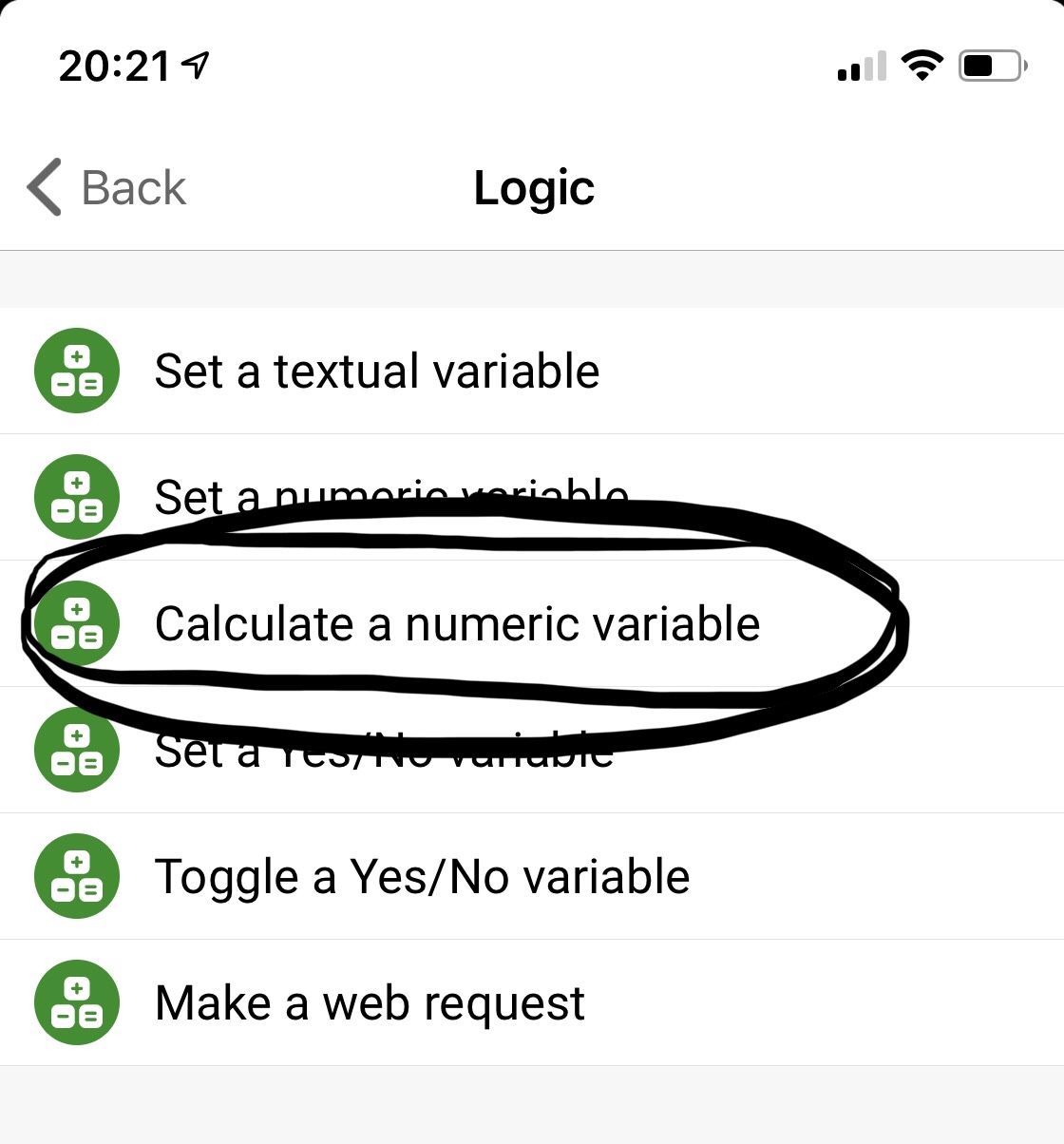

![image](https://us1.discourse-cdn.com/flex025/uploads/athom/original/2X/2/2f0bca154e274932d14609d5cd114fb67d0ce83d.jpeg) ![image](https://us1.discourse-cdn.com/flex025/uploads/athom/original/2X/0/008d0d983648d4af52d75f6a32362d3698fd1452.jpeg)

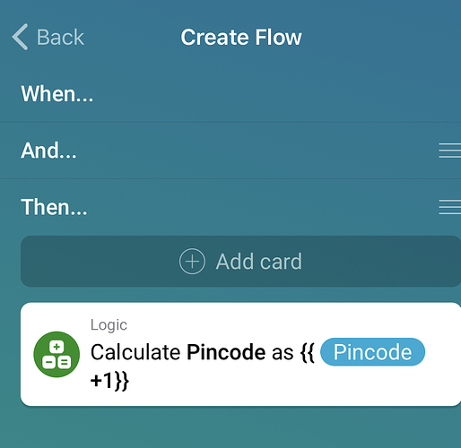

For the pincode +1 you have to choose calculate a numeric variable and make the math as in this example

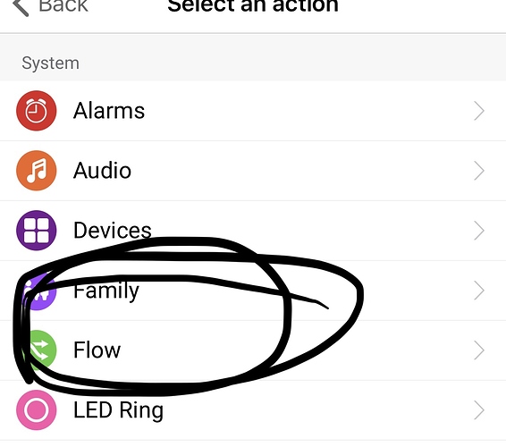

 ![image](https://us1.discourse-cdn.com/flex025/uploads/athom/original/2X/9/984023eaab7fbed13dd2aec2eb8e64f40dfc5f7c.jpeg) ![image](https://us1.discourse-cdn.com/flex025/uploads/athom/original/2X/1/1cb895d9a92225e2b504a88292adf6f79a1bee96.jpeg)
And for the disable flow as above
