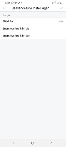

Unfortunately its not possible.

If your light and the switch are directly connected to the kaku dimmer, you can’t change something with Homey.
You could use an another switch, like fibaro or Shelly.
Maybe it’s helpful to read the kaku dimmer manual. Some kaku dimmers has a 8 level dim setting. When you change that setting, maybe the flashing will stop.
