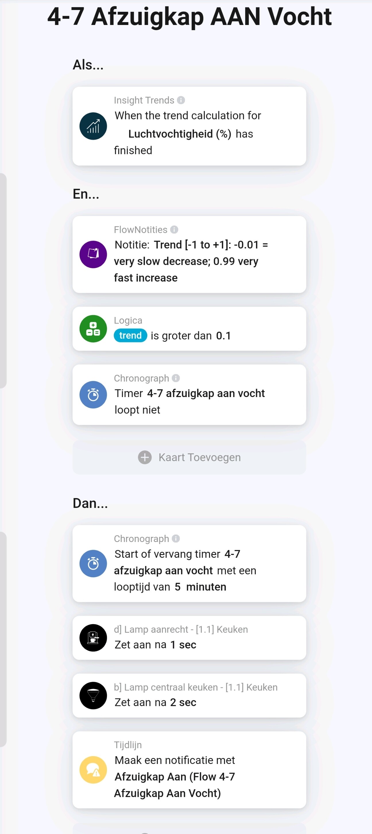

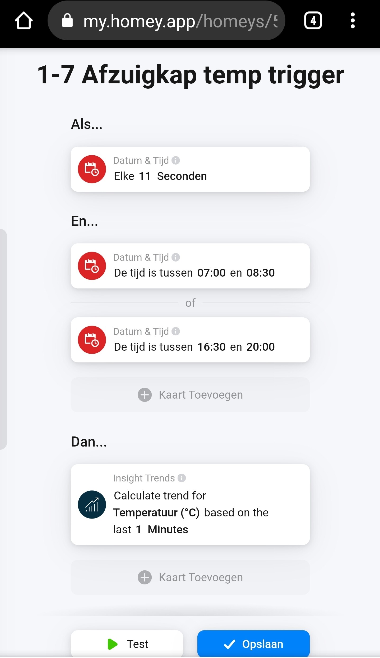

- The 1st 2 flows analyze the temperature and humidity values of the sensor; to have enough data sets (measure points), I poll it every 11 and 12 secs, not both at the same time (for load spreading).
- A little translation: Vocht = Humidity, Afzuigkap = Cooker hood
> ![Screenshot_20210411-202700_Chrome](https://us1.discourse-cdn.com/flex025/uploads/athom/original/3X/a/4/a41427796530b6204d503c7382c3095548c2b3dd.jpeg)
> ![Screenshot_20210411-202721_Chrome](https://us1.discourse-cdn.com/flex025/uploads/athom/original/3X/a/7/a7f8b67446eb8ce380d9d876ed17bbb69a7a68aa.jpeg)

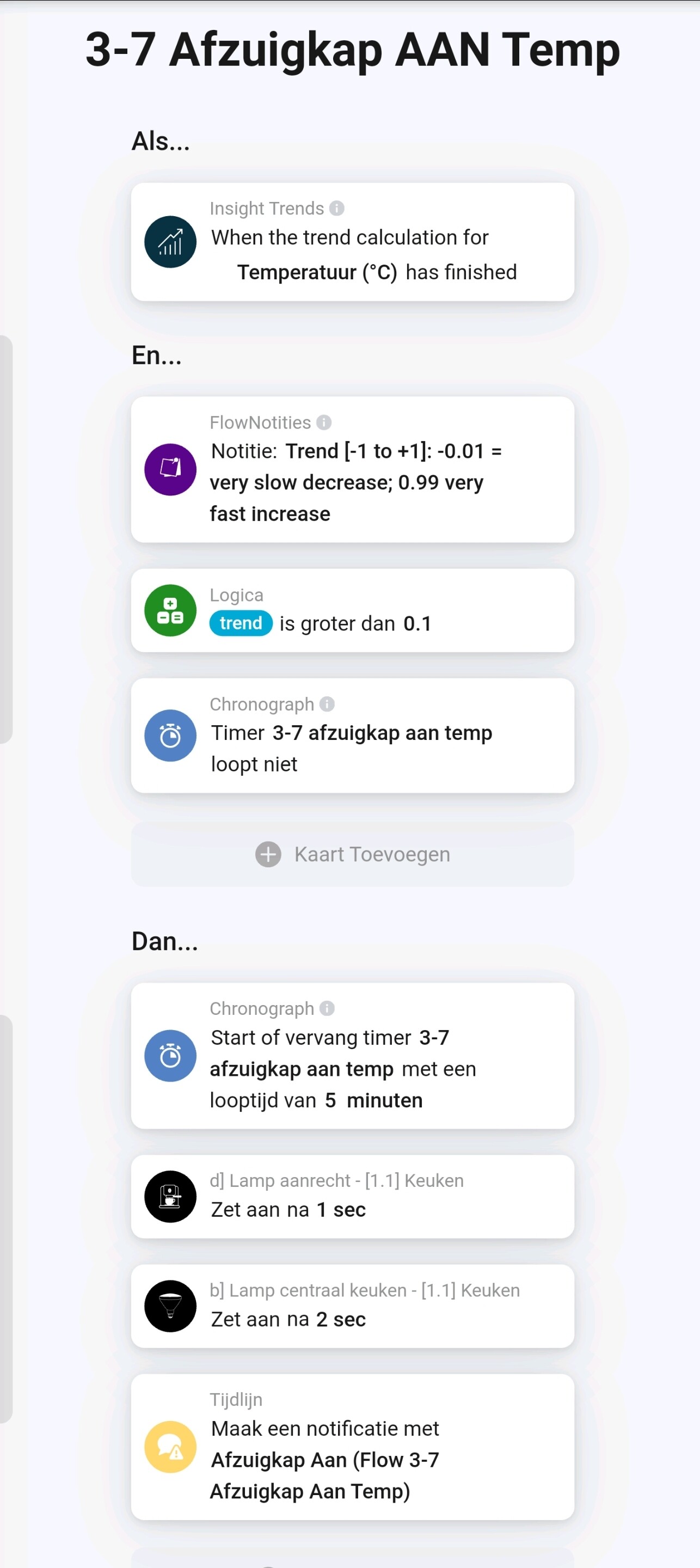

- The 3rd and 4th flows are triggered as soon as the analyzing is completed.;
While using a condition, ‘greater than’ the trend ‘index’, a decision is made whether to run the flow and to switch the cooker hood / ventilation system on
(it doesn’t matter whether the temp or humidity measurement switches the ventilation on. The quickest wins).
Example: [trend \> 0.01] temp increases very slowly;
[trend \< -0.99] temp decreases very quickly
We control it by means of a series of quick changes in time!
It doesn’t matter how warm/cold or how dry/humid the air is (provided using this in a ‘normal’ home environment).
A naturally changing temp/humidity value doesn’t trigger the flows.
> ![Screenshot_20210411-202753_Chrome](https://us1.discourse-cdn.com/flex025/uploads/athom/original/3X/c/6/c6cf81a14a38664564953db91c6f5ce08e8deb3b.jpeg)

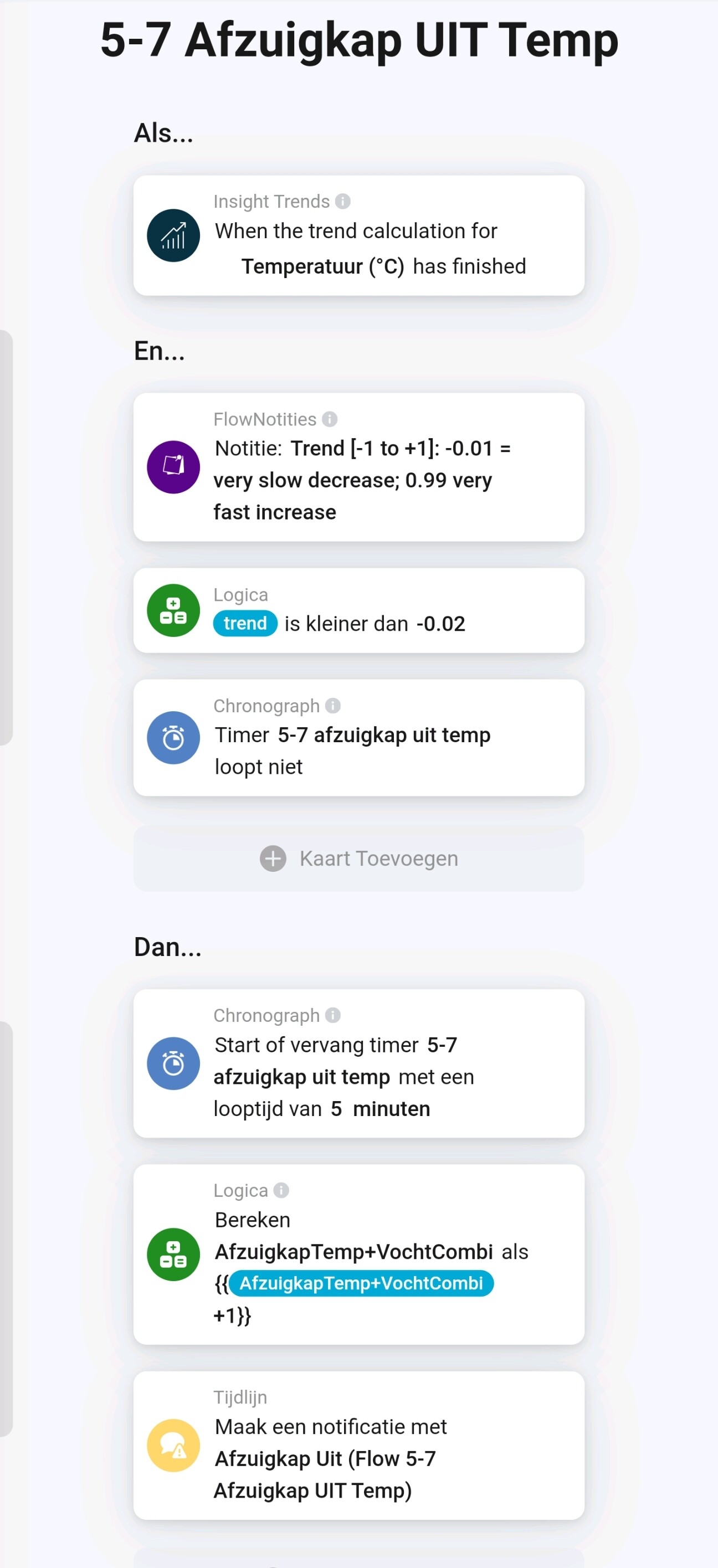

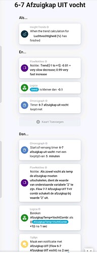

- The 5th and 6th flow decide likewise to switch the vent off
> ![Screenshot_20210411-202924_Chrome](https://us1.discourse-cdn.com/flex025/uploads/athom/original/3X/a/0/a0baa80e0a742a789a89bcb2467a82e5e1fa1ad1.jpeg)
> ![Screensh0210411-203001_Chrome](https://us1.discourse-cdn.com/flex025/uploads/athom/original/3X/a/c/ac57e1bb5c76e25ffe16e3fc97cf52e0af1b3366.jpeg)

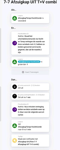

- the 7th and last flow does the actual switching off of the ventilation, only when both flow 5 (temp) and 6 (humidity) set the ‘switch off’ signal
This seems wise because the humidity or temp could quickly change because of the air flow going on.
> ![Screenshot_20210411-203059_Chrome](https://us1.discourse-cdn.com/flex025/uploads/athom/original/3X/6/e/6e1518fa46f499103b7d2c6c67322d5a5921e75b.jpeg)
