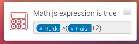

Does anyone here happen to know how you can turn numbers into a flow? I want to convert a lux value to a number of, for example, 80 lux\> 0.8. is this possible at all?

KSure you can 😀
Use better logic, with a math.js command you can do al kind of calculation.
This is a simple one:
Pull in the tag (in my case #helderheid) from your device
i use it to prevent my light going off right after they are turned on (turning on increases lux measured lux a bit)
They are turned on when #helderheid (measured lux) \< huiskamer donker (a variable in better logic)
But I only turn them off if that value is 2 lux higher
![image](https://us1.discourse-cdn.com/flex025/uploads/athom/original/2X/7/7a3cc41aaea8aebe2f3305309e60e36c707205a3.jpeg)
You can calculate the same way with your lux:
 ![image](https://us1.discourse-cdn.com/flex025/uploads/athom/original/2X/2/23d12256bfc9787300a843b2b0791ae9c82ad2bf.jpeg)
(Sorry, you probably need to put brackets around to make it work, but I think you get the idea)
