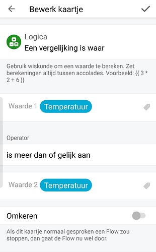

You could do something like this:
Use a logics card “if calculation is true” as a condition.
**IF** outside temp exceeds 20°C
**AND** tag [outside temperature] is equal to or is higher than tag [inside temperature]
**THEN** switch AC on
The logics card (it’s rather confusing you can’t see to which device the tags belong if the tags are named alike):
 ![Screenshot_20210812-123247_Homey](https://us1.discourse-cdn.com/flex025/uploads/athom/original/3X/6/b/6b528488a2e2df3d2b7f4ace6b7cc5cf85645aaa.jpeg)

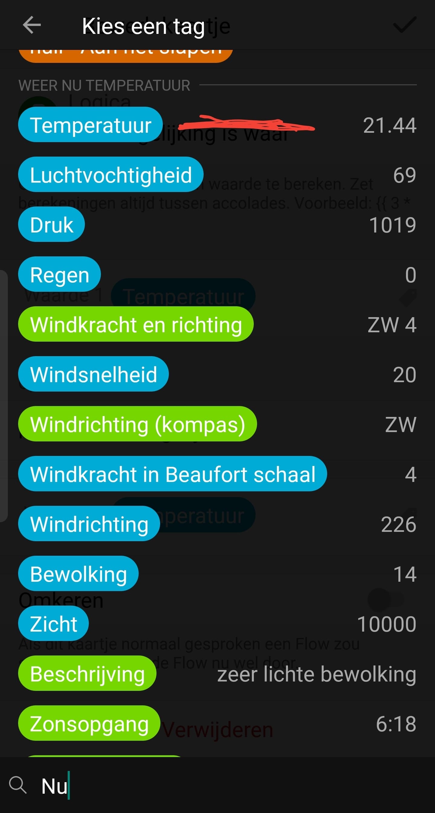

The first [temperature] tag is this one (weather app temperature):
 ![Screenshot_20210812-123328_Homey](https://us1.discourse-cdn.com/flex025/uploads/athom/original/3X/3/9/39a02c89d7cbd3cd1fefb332732fc1e76d8aa86a.jpeg)

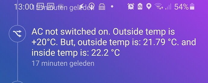

Timeline after pushing flow test button:
 ![Screenshot_20210812-130031_Homey](https://us1.discourse-cdn.com/flex025/uploads/athom/original/3X/f/8/f81f8f98db7f794d819eac4ecf41a3d9a5ce68eb.jpeg)
AC not switched on, while inside temp exceeds outside temp.
