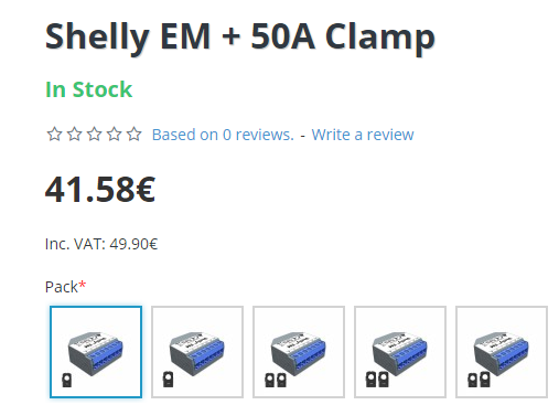

Would a 50A clamp be okay on a 32a lead?
<div class="post-metadata">
**Author:** ![JPe4619](https://sea1.discourse-cdn.com/flex025/user_avatar/community.homey.app/jpe4619/32/9017_2.png) [@JPe4619](https://community.homey.app/u/JPe4619)\
**Post date:** [February 24, 2020, 3:12pm UTC](https://community.homey.app/t/cheap-ish-energy-monitor/26318/14 "2020-02-24T15:12:42Z")
</div>
Sure why not? 50A is the max. current, so 32A is comfortable.
