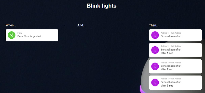

Can easily be done in a single flow like this:
 ![image](https://us1.discourse-cdn.com/flex025/uploads/athom/original/2X/3/3846c61f3ece4605df86152c94b991450c65abee.jpeg)
In the example there are 2 ON/OFF sequences and in the end the lights will be the same as they were before.
I’m not sure about the different colors for different actions; maybe you need to create a different flow for every color or maybe something is possible using variables.

Ahh Nice, thanks! Gonna try that out tonight.
I guess this way I create a reusable action which I can use for several flows. Color would be defined within the flow triggered by the event for which I require a notification.
Think I can optimize some other flows following the same technique as well.

A second lights off was somewhat disruptive. Ended up switching the lights between a color and the default color setting twice.
For some reason creating a group with colored light bulbs didn’t give we an option to change the a certain color. Only the options “color saturation” and “color temperature” where available. So I added all lights individually for now.
