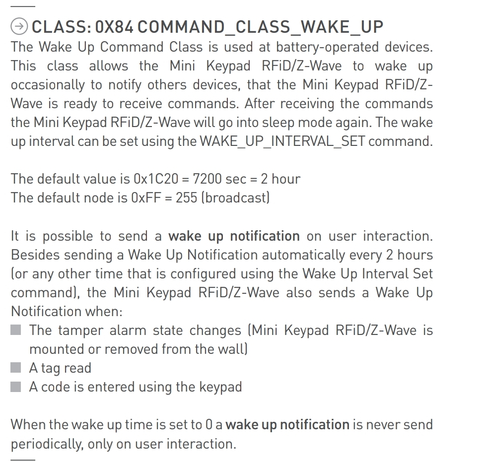

I tried already several things but still not the solution so.
 ![SmartSelect_20190408-223155_Drive](https://us1.discourse-cdn.com/flex025/uploads/athom/original/2X/f/f0b8a189cbb8f0668fc521a980aa63c7a54d8cf8.jpeg)
See attached out of the manual but is not working for me so I hope someone have the solution
