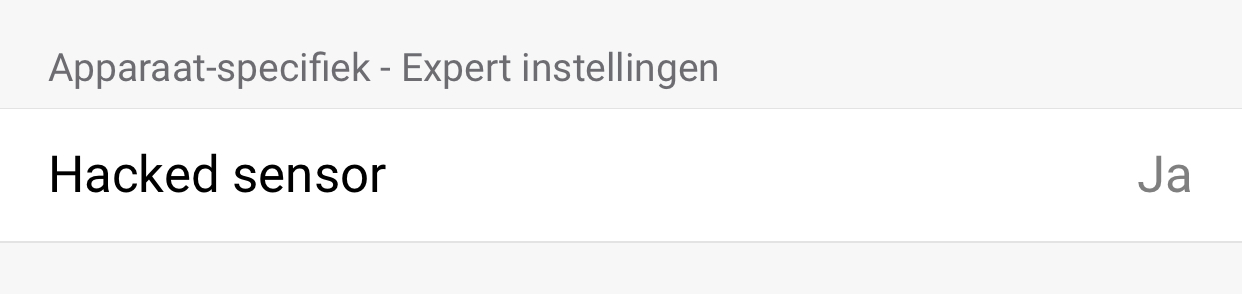

When you would like to use a hacked sensor you can change this in the settings of the motion sensor itself:
