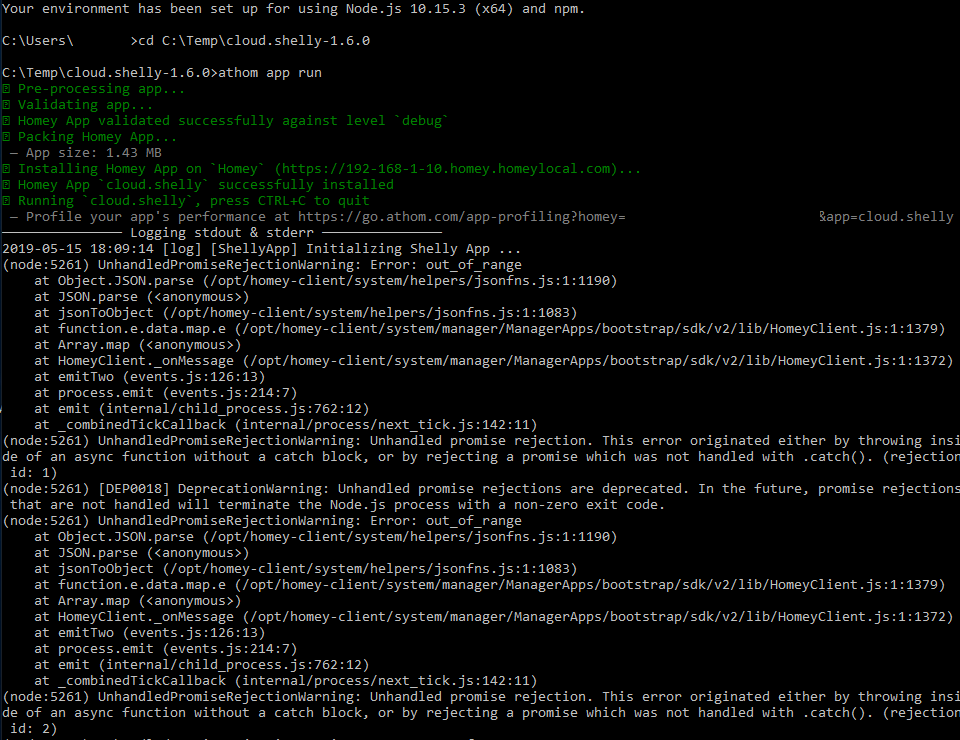

> [@Phuturist](#):
> What I still need to find out is if the previous errors you have seen occur on 1.6.0 for the Shelly 2 as well.
You mean 1.6.0 commandline install? With only shelly2 attached?
This is exactly that:
 ![image](https://us1.discourse-cdn.com/flex025/uploads/athom/original/2X/9/93fc99dac7f0f3c3f397ad65200382d94e48a7d7.png)
But I will do this again to make sure sure.

commandline install 1.6.0, with only shelly2 attached:
 ![image](https://us1.discourse-cdn.com/flex025/uploads/athom/original/2X/4/4725e7d0163a8a31469456f415d431a2237663b8.png)

Ok, I need to fix that first before I can have a further look at the Shelly2.5 driver. I have uploaded version 1.7.0 with extra logging for the Shelly 2 driver. Could you run this and let me know what it returns.

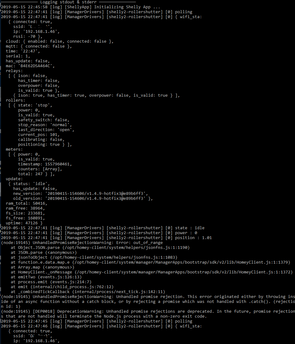

yes sir:
commandline 1.7.0 shelly2:
 ![image](https://us1.discourse-cdn.com/flex025/uploads/athom/original/2X/9/9d187cd6b097e384fac4616f323a23c21f39cc35.png)

**Author:** ![Phuturist](https://sea1.discourse-cdn.com/flex025/user_avatar/community.homey.app/phuturist/32/49_2.png) [@Phuturist](https://community.homey.app/u/Phuturist)\
**Post date:** [May 15, 2019, 6:16pm UTC](https://community.homey.app/t/app-shelly-smart-solutions-for-every-home-and-office/765/209 "2019-05-15T18:16:22Z")
</div>
Have you paired your Shelly 2 as relay or rollershutter? I’m not seeying the extra logging I have added to the Shelly 2 relay driver.

That’s ok. I just uploaded a version that adds debug logging that should tell me the source of these errors. Once I have that fixed I can continue to look at the Shelly 2.5 driver. Give it a swing.

ok, 1.7.0 with shelly2 rollershutter attached
 ![image](https://us1.discourse-cdn.com/flex025/uploads/athom/original/2X/1/132bc99c3d21177665d47f7177a596f38462cc9e.png)

Right, I see what is causing the issue. In the data you can see the rollers current\_position is set to 101. As this is a percentage it should not be allowed to exceed 100. Obviously this is a bug in the Shelly 2 API and or firmware. Homey returns a out\_of\_range error when I try to set the roller position to 101%.
I have added a check in my app to prevent this from happening so we can continue to troubleshoot the Shelly 2.5 driver. I have added extra logging to do so, please run the new version from GitHub and let me know the outcome.
