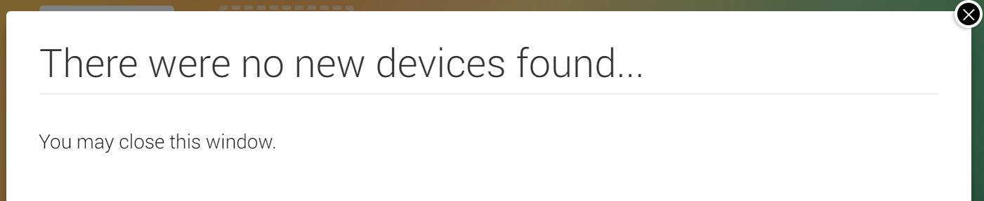

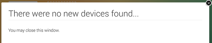

Edit2: Also, can you tell me how I can add these devices now? I have tried to add them again via the devices and even after having removed the old one it’s not finding the bulbs (LAN mode is on…)
 ![image](https://us1.discourse-cdn.com/flex025/uploads/athom/original/2X/6/6aec67e8217dfede3aa28b5da75ec38cb1a42d7f.png)

The IP is currently saved in the data object of the device. I dont think it’s possible to edit/update this any other way than with a Homey app. Seeying the issues you are having I will move this to the settings object and make it available for editing under the device settings. But that’s of no use to you right now.
Try restarting the app after removing the bulb before doing a new discovery. That should clean any temporary data which can cause the light to not be discovered.

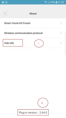

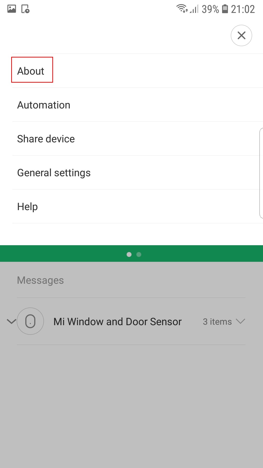

Hello
I tried all the methods to find the token of the bridge, without success (1, 2, 3 …) and I realized that there was more simple: ( Activate the mode develloper)
**Android:**
**Gateway**
1. About
2. Several click on plugin version
3. Hub Info
![Screenshot_20181102-210237_Mi%20Home](https://us1.discourse-cdn.com/flex025/uploads/athom/original/2X/c/cad301142fe2ae64e7ed8ec509892ac4cb50fa7f.jpeg) ]!
 ![Screenshot_20181102-210248_Mi%20Home](https://us1.discourse-cdn.com/flex025/uploads/athom/original/2X/8/8aa35acfcc182dcb9c0d083f6380219fa9b88e5b.jpeg) ]!
 ![Screenshot_20181102-210316_Mi%20Home](https://us1.discourse-cdn.com/flex025/uploads/athom/original/2X/c/cd08ab4ebef0f0cff6e200994806622eab020cd3.jpeg) !
Cordially
