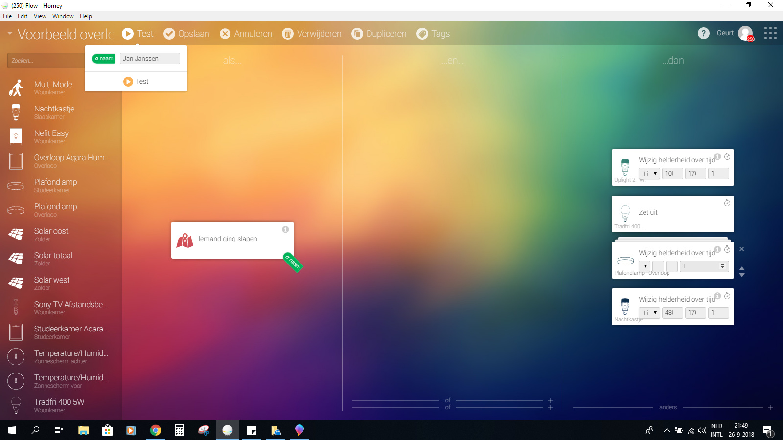

![Ceiling%202%20minutes](https://us1.discourse-cdn.com/flex025/uploads/athom/original/2X/0/0af58f802ff3c0129c3c9e1ab836b3762ce55a18.jpeg) ![Ceiling%20Brightness%201%20procent](https://us1.discourse-cdn.com/flex025/uploads/athom/original/2X/a/a839d2a7a9d4bc37fa5e048bcb7440c8e4af40bc.jpeg) ![Ceiling%20Behoud%20Staat](https://us1.discourse-cdn.com/flex025/uploads/athom/original/2X/5/519bb06fbb97b2387fe1bb382d1cb76b59318bc7.jpeg) ![Ceiling%201700%20Kelvin](https://us1.discourse-cdn.com/flex025/uploads/athom/original/2X/4/45d252cba96f575e51c6a99fe2f953ea5aa3089b.jpeg)
It’s quite hard to explain how and what I did so I took some screen shots. The third light from top is my ceiling light.
Is it perhaps not correct how I turn off the ceiling light? For the bulbs this way works fine.
After you shared the code I tried it and for the brightness it works, only the counter is too fast.
Perhaps you also know how to change the timer or where I can find the manual for this light.
Edit: When I say now “Good Night” the Ceiling goes to moonlight and nearly 1%. On the end of the flow it goes back to bright light. To be clear, I want it moonlight 1% all night long.

> [@Geurti](#):
That it goes back to bright after the “change brightness over time” card timer has completed seems to be a bug in the Yeelight API (have not tested that myself). If you set it to keep the state it should not switch back to bright light.
I’m not sure how to achieve what you want, best is to look into the API description yourself and use the send command card. It’s pretty well documented: [https://www.yeelight.com/download/Yeelight\_Inter-Operation\_Spec.pdf](https://www.yeelight.com/download/Yeelight_Inter-Operation_Spec.pdf)
