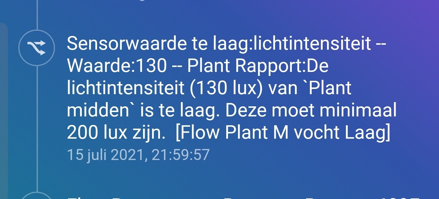

A small note, for me not too important:
A flow like this:
“When a sensor’s value is below the threshold
And the plant has not the right amount of moisture”
It sends also reports about the lux level being too low, while it only should report when the moisture is too low.
Flow:
Report:

That’s not a bug, it does exactly what is should.
So when the plant has not the right amount you get a message from every sensor’s value that is below the threshold.
You should add a condition logic card:
And {tag local sensor type} = ‘moisture’

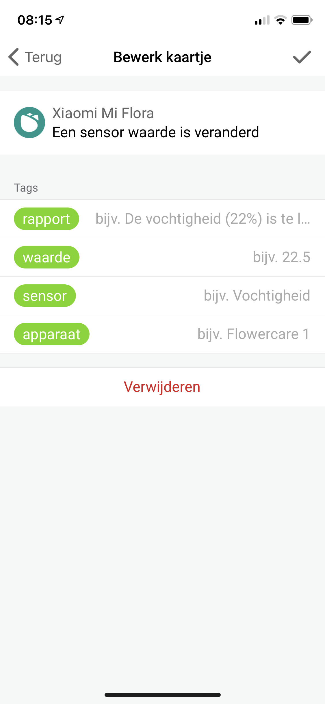

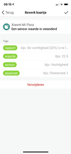

I was reviewing some flows and found that there’s also a global trigger for changed sensor values… Right now I have a flow per sensor (and I have 20) which creates a very long list, I wish to put (almost) all sensors in one flow… I guess the global trigger is good for this.
The only thing I found is that the value (waarde) tag is niet programmable inside a higher/lower logic card. Might this be setup as a string instead of a number?

What do you mean with: Is not programmable? You can use it with a condition card if you like (homey logic/better logic). Changing the ‘value’ to a sting isn’t logical, that way you can’t calculate anything with it for example.

No I ment the other way around, is it maybe currently set to a string and not a number?
When using the global tags choosing “A sensor value changed”, going to the “AND” part and choose “Value is below X” out of the logic cards the tag “moisture” (or any other) is not showing.According to the trigger card it should give me “rapport, waarde, sensor, apparaat”.
Choosing the logic card “is exactly” IS giving me the given tags that the trigger provides.
This indicates to me that the global tags are currently set to string and not number, that’s why they show up in the string related logic cards but not the number logic cards.
I might be completely wrong, but this is the only logical reason I can think about?
**Example:**
**IF** A global sensor value has changed
**AND** The given moisture is below XXX using a logic card
**THEN** Push message “I’m thirsty!”
This is currently not working since the moisture level is not showing in the logic card.
Using this same method with a device related trigger “the sensor has changed”, soo not the global one, it is possible and working the way it should!

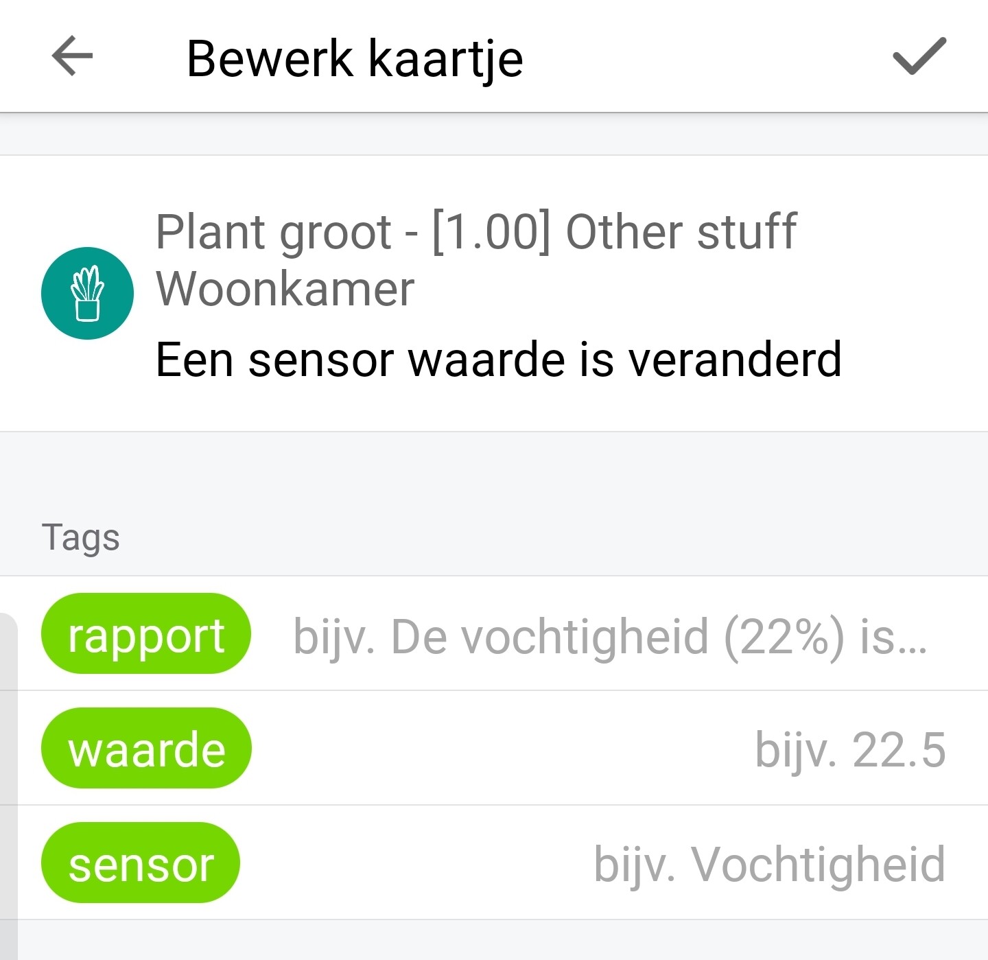

Sharp observation, Justin.
Unlike you, I encountered the same issue with a device related trigger "a sensor’s value has changed.
**IF** My Plant X a sensor’s value has changed

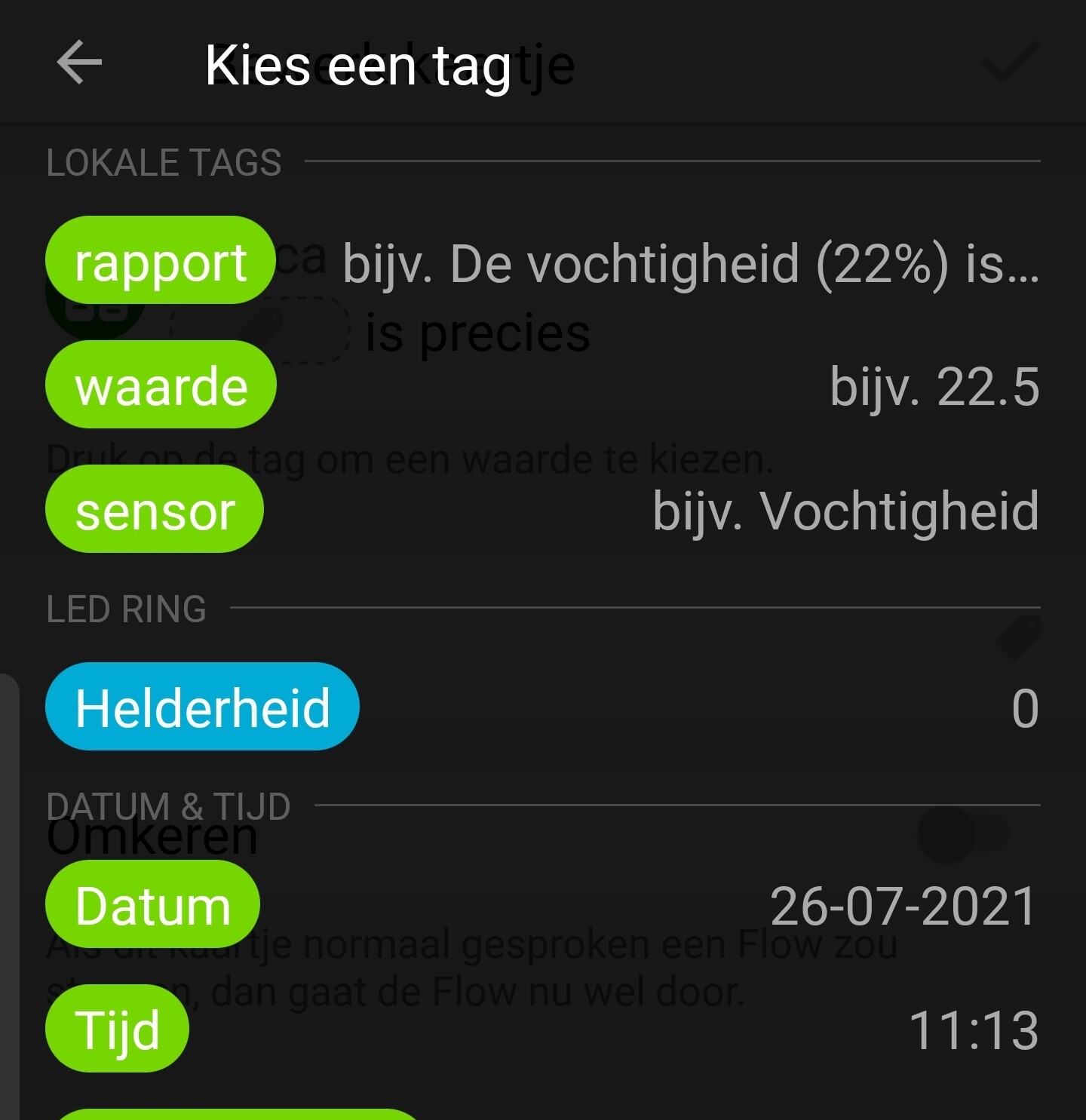

I worked around this by browsing to the tags/variables at the logics section of the device itself, where the ‘blue’ moisture tag/variable is available, _but it should be available at the local tags section._
It can also be viewed when selecting the IF card, _all_ tags are green, while the value (= ‘waarde’ in screenie) tag should be _blue_.

Yes, you’re right… I see now that I also used the global variable “moisture” instead of the trigger flow variable. Wasn’t even aware of that!
In this case it’s not a bad thing, how well it may also be called a “bug” since you’d expect the trigger flow for one single device would give the tag “moisture” as well. But using the global variables is a fine option…

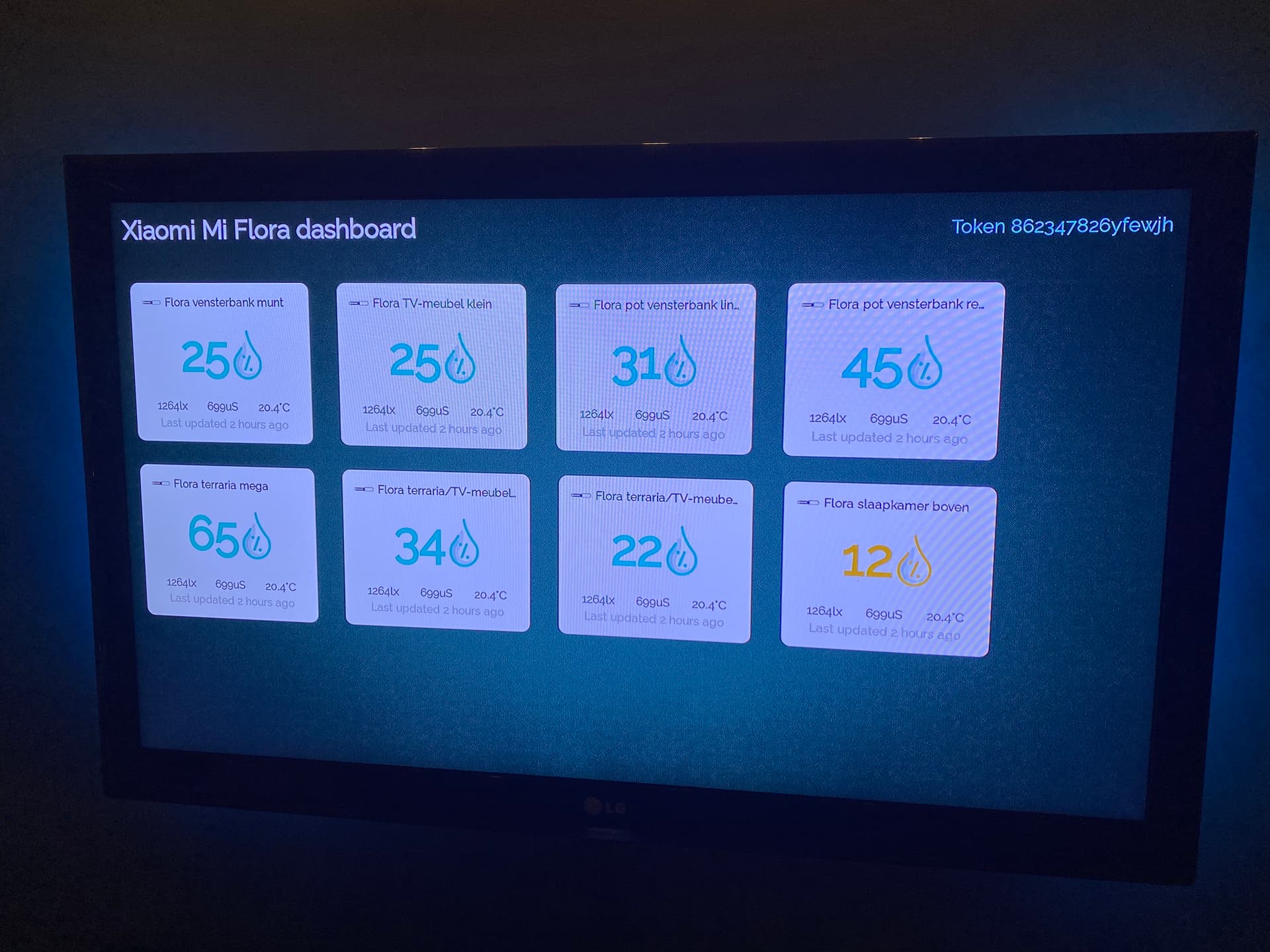

@Koktail, might you be interested in teaming up for this app creating a webbased “dashboard” that is able to show the status of all your flowers on your television?
My wife is requesting this and I think it’s a pretty cool idea. I’ve got about 15 sensors now and 5 more are on it’s way. I could create a webbased dashboard that’s listening to a special token and a webhook function, maybe you can create a flow that triggers sending this data towards the dashboard for each sensor, one by one, were the dash picks this up and displays the results one by one?
Users may stream these results through Chromecast towards the television or Google Hub screens…

I’ve already made something like that: [GitHub - koktaildotcom/homey-mi-flora-dashboard: View the status of Xiaomi Mi Flora Plant Sensors](https://github.com/koktaildotcom/homey-mi-flora-dashboard)
You can use that to get the data out of homey.
