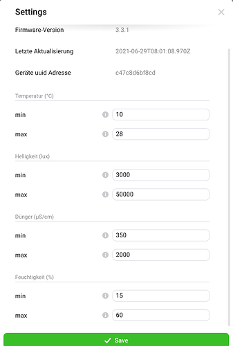

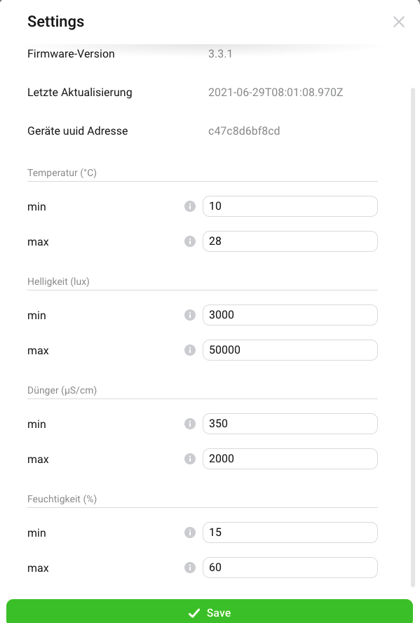

Here is how I can reproduce: my plant has 67% humidity. Threshold is set to 60%
Flow: . If Sensor is below threshold AND water is missing THAN sent a notification.
I will get the notification.
If I set the threshold to 67% and above no notification is sent.

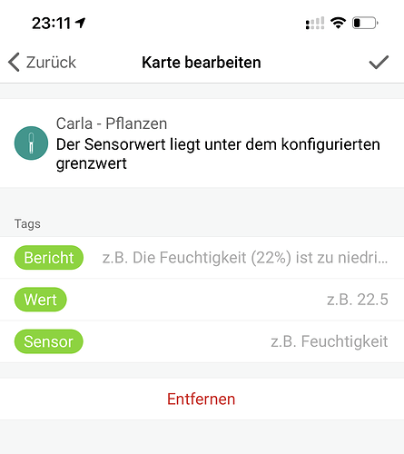

What says the rapport tag of that trigger flow?

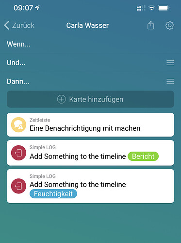

Can you help how I will get that content?
 ![Flow.png](https://us1.discourse-cdn.com/flex025/uploads/athom/original/3X/0/7/07f837015a6c5dbef914e5f66b632d15284732d2.png)

Log the ‘Bericht’ tag.

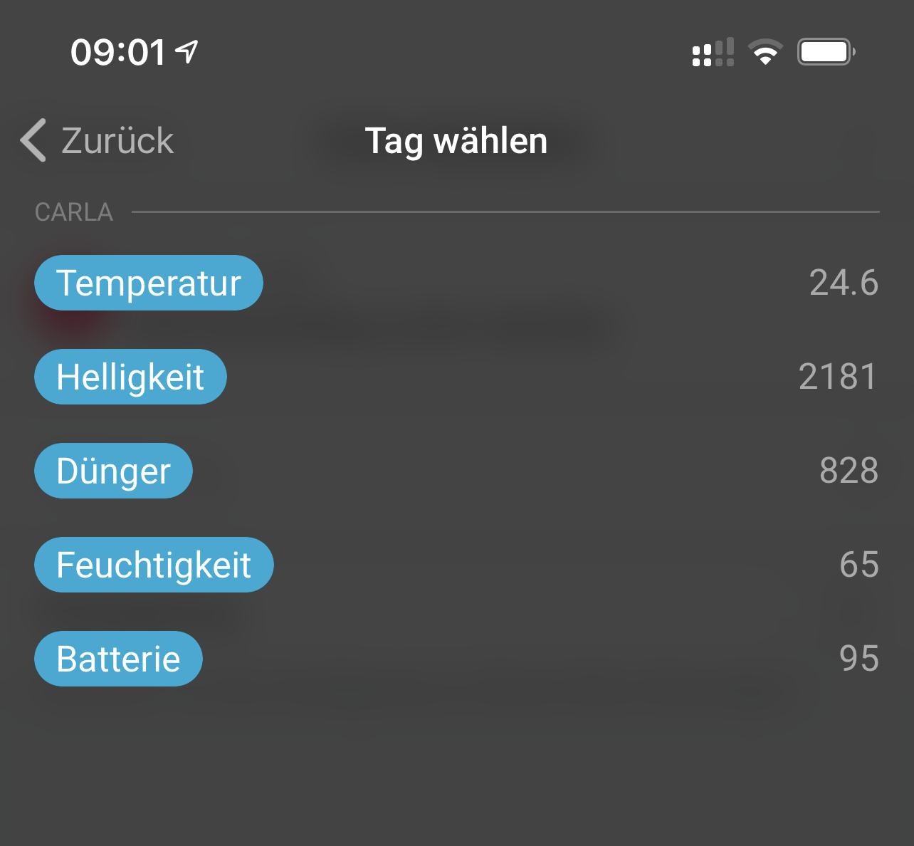

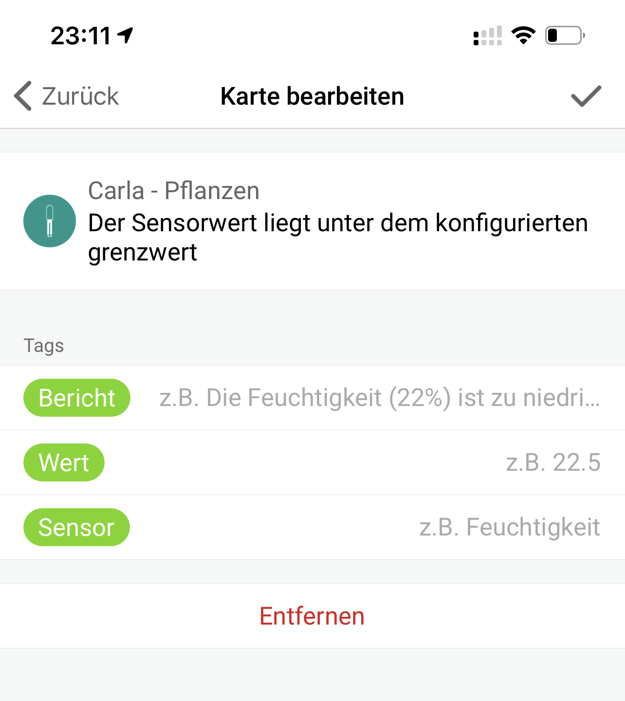

Here are the result. Humdity is 65. But Rapport told is 22%

Here is the actual timeline. (Not started with test;-))
 ![Timeline](https://us1.discourse-cdn.com/flex025/uploads/athom/original/3X/5/c/5cebe3408002abc7fe8b5a5e912162c99b108674.jpeg)

Ok. Strange Please can you point me to the right direction than. Thanks
This want I want to achieve:
If a plant has not enough humidity or fertilization I want a notification. Only if it is not enough not if it is too much.
I start with:
A Sensor is below threshold
And water is not enough
Than send notification
It‘s strange why rapport tag is speaking about light…
Not about water .
It‘s indeed too dark but I don‘t use that number in anyyfloe
I will recreate the flow, maybe that will fix it

Short addition if I replace the AND condition with logic TAG Pflanze Feuchtigkeit is smaller than 15
It will work. I don‘t get a notification
If I use Pflanze hat zu wenig Wasser it is not working. I
Get a notification
Tag Feuchtigkeit has value 65…
