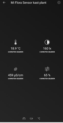

Works really well now 🙂 @rvdeijk
 ![Screenshot_20201125-095430](https://us1.discourse-cdn.com/flex025/uploads/athom/original/3X/7/3/7393c62c5f1685e92a9f271ef63cd86fddec8e81.jpeg)
