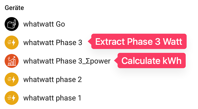

Why the Virtual Device? I created the virtual devices for Phase 1, 2, and 3 in order to:
- monitor the load on each phase separately,
- and have the separated total daily consumption for each.
 ![SCR-20250923-jozz](https://us1.discourse-cdn.com/flex025/uploads/athom/original/3X/6/5/6596432306839a1f28f4b717162d6a019fabe56f.png)
Has anyone else seen this behavior, or found a way to keep the app stable without having to restart it manually?

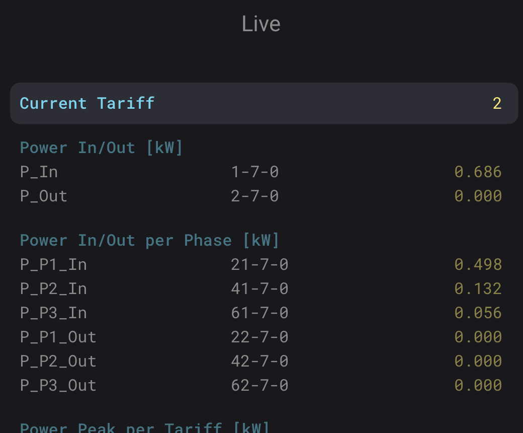

Congratulations on the official launch 🎇
Do you think the “Current tariff” value could be used to feed Homey dynamics pricing?
