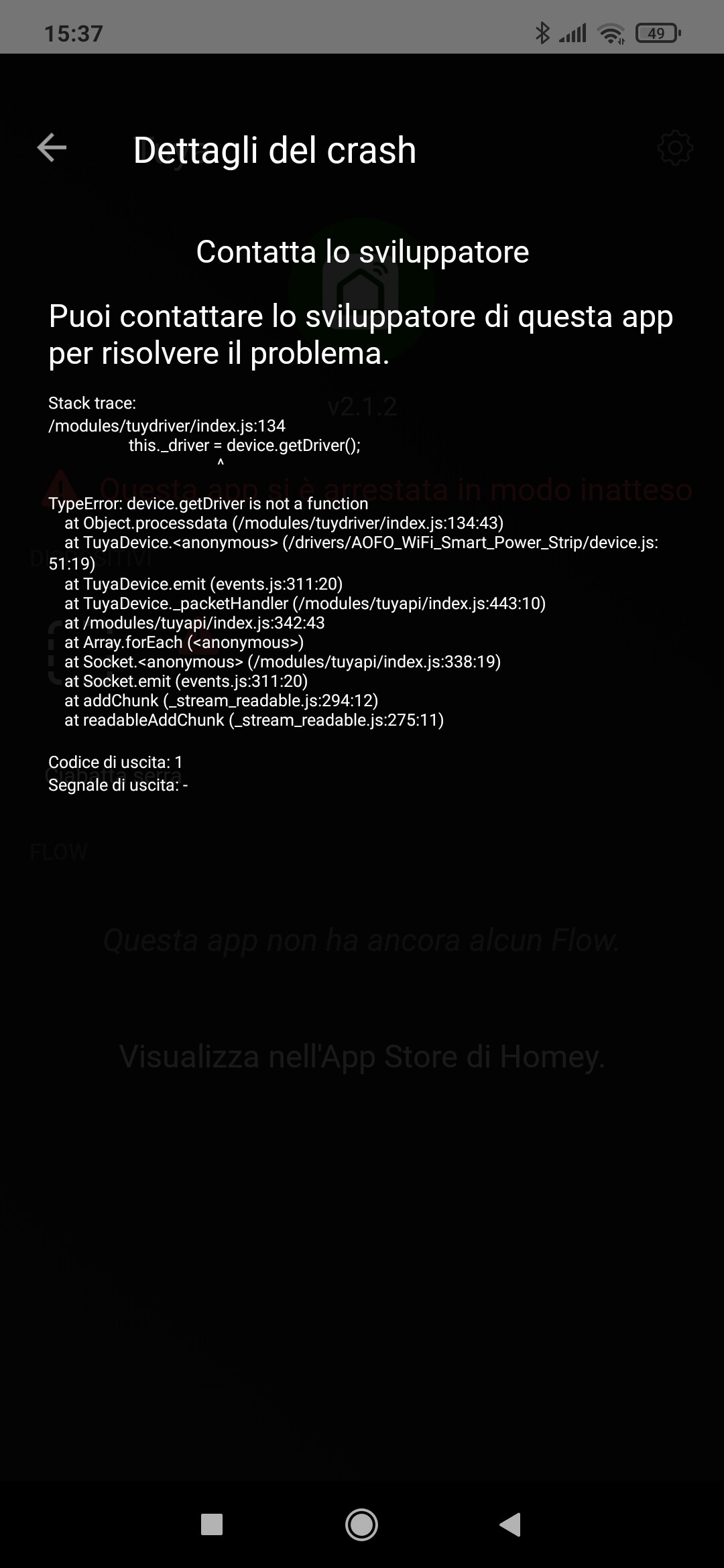

I added my Aofo Wifi smart power strip but now I get “This device is currently unavailable” message.
Why? 😞
 ![IMG_20210327_152724](https://us1.discourse-cdn.com/flex025/uploads/athom/original/3X/0/c/0cd9a40c4727ce42669704f347ee6eb8535dd576.jpeg)
EDIT: actually, seems like the app crashed
 ![Screenshot_2021-03-27-15-37-12-514_app.homey](https://us1.discourse-cdn.com/flex025/uploads/athom/original/3X/8/3/8347b5f138ec6514a637dc9574a981c972d9720a.jpeg)
@Rens_Brandwijk can you fix it?

I checked in a fix into the test build. Can you test this for me.
