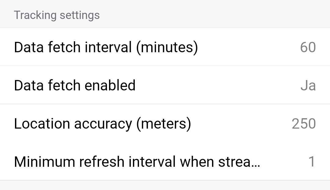

I now have these settings.
 ![Screenshot_20210223-014848](https://us1.discourse-cdn.com/flex025/uploads/athom/original/3X/5/b/5b8bb446d7a5e002c84ccc5c24ae9c898f2f9586.jpeg)
If I understand you correctly, will my settings update the status every 1 minute when the car is awake and only every 60 minutes when it is asleep?
<div class="post-metadata">
**Author:** ![balmli](https://sea1.discourse-cdn.com/flex025/user_avatar/community.homey.app/balmli/32/1308_2.png) [@balmli](https://community.homey.app/u/balmli)\
**Post date:** [February 23, 2021, 5:50am UTC](https://community.homey.app/t/app-pro-tesla-smart-charger/30648/87 "2021-02-23T05:50:00Z")
</div>
No, not exactly.
With 60 minutes, and data fetch enabled, it will check the status of the car every 60 minutes. That will wake the car up if it is asleep, and it will stay awake for 10 minutes. The 10 minute awake period is by Tesla’s design.
With the latest release (v. 1.2.4), it will also see that the car awakes, and if it start charging or driving it will continue to fetch data every minutes until it stops charging or driving.

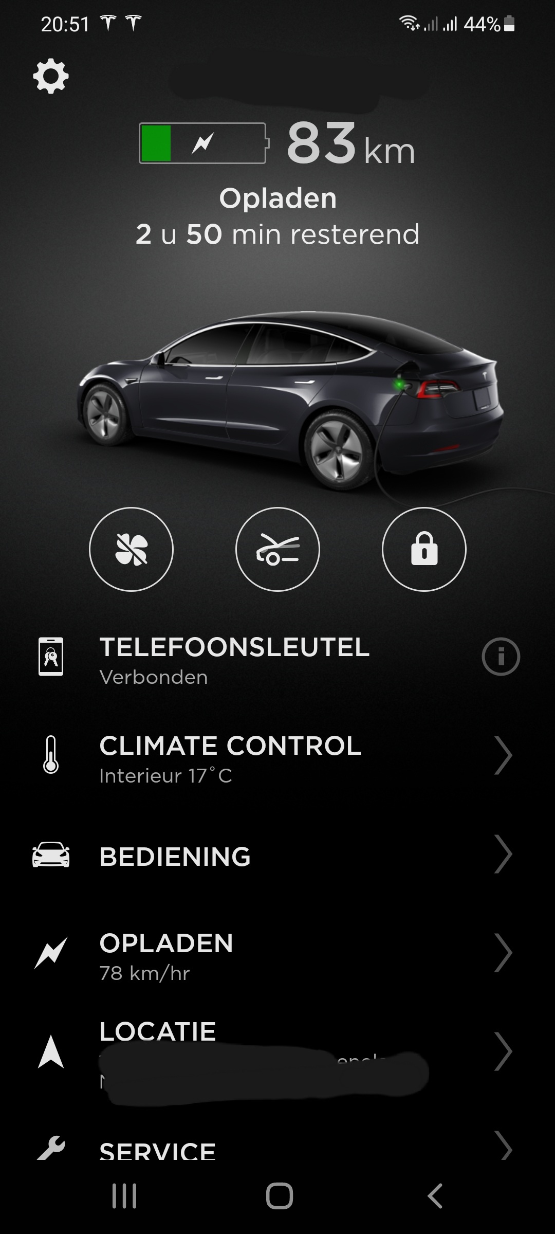

Seems like today it is not always detecting when i’m driving. What can i check to prove my point?
**Author:** ![LukDG](https://sea1.discourse-cdn.com/flex025/user_avatar/community.homey.app/lukdg/32/16851_2.png) [@LukDG](https://community.homey.app/u/LukDG)\
**Post date:** [February 24, 2021, 7:56pm UTC](https://community.homey.app/t/app-pro-tesla-smart-charger/30648/94 "2021-02-24T19:56:34Z")
</div>
![Screenshot_20210224-205136_Tesla](https://us1.discourse-cdn.com/flex025/uploads/athom/original/3X/f/c/fc37217fe0abd1555a5b53e278b3c6efbdfc1f85.jpeg) ![Screenshot_20210224-205155_Homey](https://us1.discourse-cdn.com/flex025/uploads/athom/original/3X/6/6/66b14dd28b2fb381fe12c6004aebf2a10e870b92.jpeg)
Charging now… but not visible in the Homey
**Post date:** [February 25, 2021, 6:46am UTC](https://community.homey.app/t/app-pro-tesla-smart-charger/30648/95 "2021-02-25T06:46:05Z")
</div>
Don’t worry, We’ll find a solution for this that works 🙂
