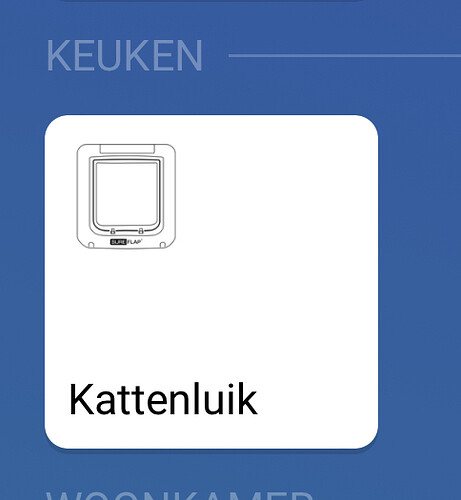

<div class="post-metadata">
**Author:** ![Peter\_Roest](https://sea1.discourse-cdn.com/flex025/user_avatar/community.homey.app/peter_roest/32/30347_2.png) [@Peter\_Roest](https://community.homey.app/u/Peter_Roest)\
**Post date:** [January 1, 2022, 11:17am UTC](https://community.homey.app/t/app-pro-sure-petcare-app-sureflap-pet-door-sureflap-cat-flap/24127/183 "2022-01-01T11:17:44Z")
</div>
Thanks. The problem is that I don’t see the flap between the devices.
I see it when n the ‘if’ part but not in the ‘then’ part.
 ![image](https://us1.discourse-cdn.com/flex025/uploads/athom/original/3X/6/8/68ea8b08a1be0a70b6a5a5e6da71e6c50bb622d9.jpeg)
 ![image](https://us1.discourse-cdn.com/flex025/uploads/athom/original/3X/2/c/2cd5804dfb98183f686c1bb28ab32c8acd6bbafc.jpeg)
**Author:** ![oddvarr](https://sea1.discourse-cdn.com/flex025/user_avatar/community.homey.app/oddvarr/32/39621_2.png) [@oddvarr](https://community.homey.app/u/oddvarr)\
**Post date:** [January 1, 2022, 11:41am UTC](https://community.homey.app/t/app-pro-sure-petcare-app-sureflap-pet-door-sureflap-cat-flap/24127/184 "2022-01-01T11:41:12Z")
</div>
What are you using as “When”?
I could try the same parameter and check if I can see it in “Then”
Also, what version are you running?
I am using v2.0.4 experimental
Homey Pro running 7.2.1
