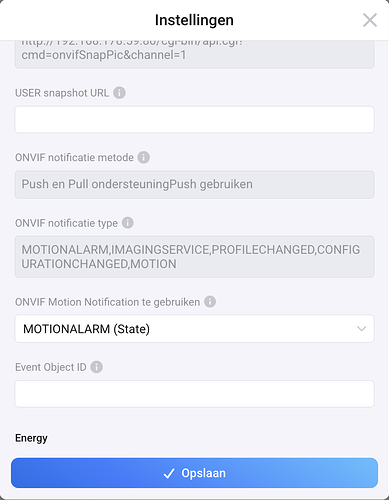

Hi Adrian, my Reolink NVS 8 now supports line crossing, and it works in the Reolink app, but not in Homey. I've enabled line crossing in the settings. Is the notification type complete? See the attached photo.
Hi Adrian, my Reolink NVS8 now supports line crossing and it works in the Reolink app, but not in Homey. I’ve enabled line crossing in the settings. Is the notification type complete? See attached photo.
Can you send the information log from the app settings page.
  1. Make sure motion detection is switched on the Homey device.
  2. Set the log level Detailed information.
  3. Trigger the line crossing on the camera.
  4. Send the log.
Hi Adrian, I’ve send you the logfile.
The log is not showing any line crossed events, only motion and person detection. The app subscribes to all events, so if the camera was sending them, they would appear in the log.
