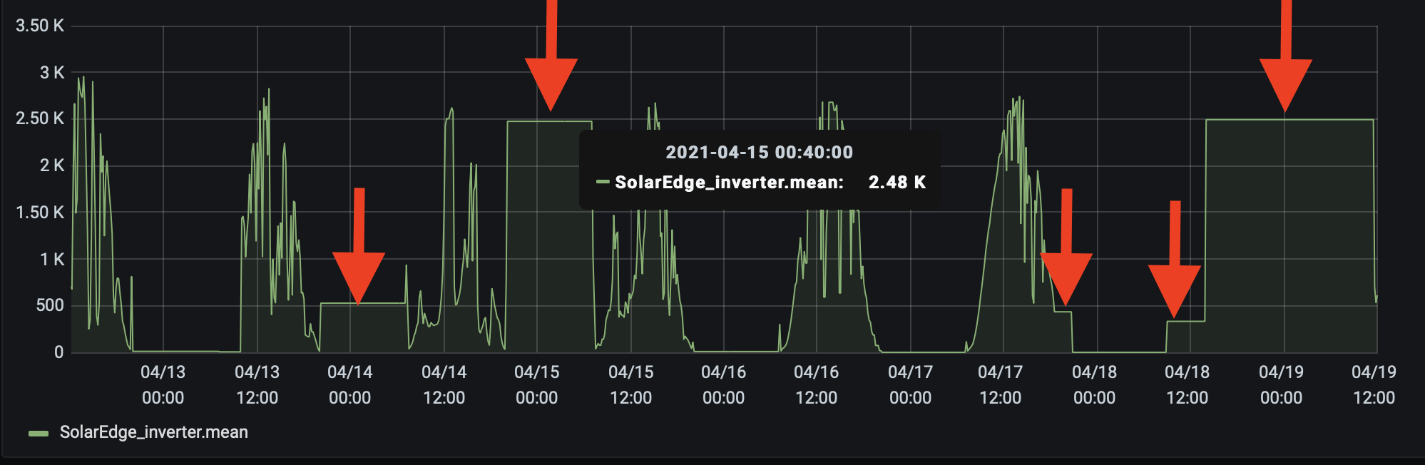

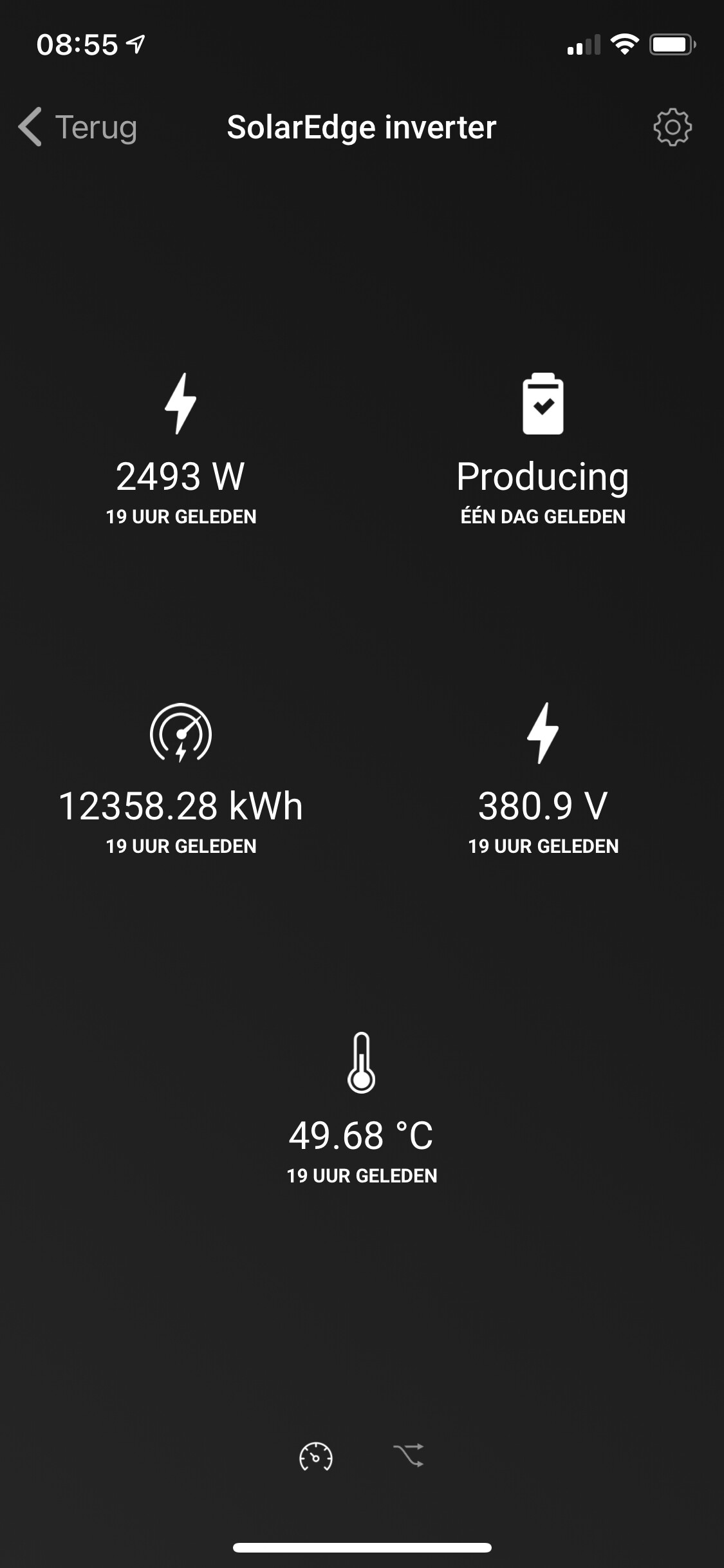

It looks like the app is not stable.
At certain moments the app is’t showing the right values. The solution is then to restart the app. On the inverter it says connected.
This happened for me several times the last days.
 ![DAF0C72F-9F97-456F-936C-0600D38058CC](https://us1.discourse-cdn.com/flex025/uploads/athom/original/3X/1/3/13b3c2c44a12e9afc5c5ed4c430f135d8a0e5fd9.jpeg)
In the next graph you see the flat lines where the app isn’t working:

I guess this happens when there is a network issue and the data is not in sync anymore
What is your polling interval.
I have to investigate how to fix this

The polling interval was 10. I have set it to 20 now.

Also an interval of 20 gives problems.
On the inverter **Modbus TCP: Connected** but the app on Homey has received data 2 hours ago.
You have received an diagnostic report with ID: d398a096-1842-4f2a-8ef3-7efcb19d4128

I can see in your log a _“ECONNRESET”_
This means the other side of the TCP conversation abruptly closed its end of the connection. (loss of internet or wifi)
Currently the app stays connected to the inverter all the time (connected)
Even if an error appears or no data is received, it will stay connected and just try again after 5 seconds
Only when the connection is really ended (loss of network), it will disconnect.
I will implement some advanced settings, that you can change this 5 seconds and that you can disable to auto retry. (so the app will disconnect from the inverter, and automatically try to reconnect after +/- 60 seconds)
