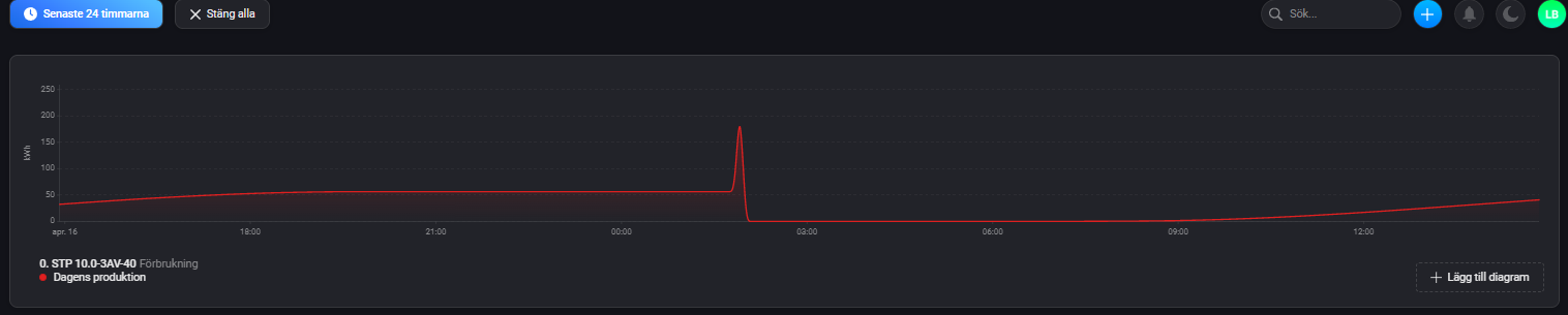

I posted a problem on github, have anyone else noticed a spike in production at night right before reset?
> <https://github.com/ricott/sma.modbus/issues/25>
> At about 02:00 it spikes the production. At 01:55 daily is 56,37 kWh and at 01:5…9 it is 253,98 kWh and at 02:00 it is reset to 0 kWh.
> Using a STP-10.0-3AV-40 SMA for my system with modbus.
> Since im using power by the hour to calculate how much the system is producing it gives very very strange numbers ;)
> \<img width="758" alt="Skärmbild 2023-04-17 145637" src="https://user-images.githubusercontent.com/119499681/232492240-327d6fa3-e624-4c21-a266-fd2367a28fb9.png"\>

**Author:** ![Lennie\_Bergqvist](https://sea1.discourse-cdn.com/flex025/user_avatar/community.homey.app/lennie_bergqvist/32/58059_2.png) [@Lennie\_Bergqvist](https://community.homey.app/u/Lennie_Bergqvist)\
**Post date:** [May 9, 2023, 10:58am UTC](https://community.homey.app/t/app-pro-sma-energy-my-home-my-energy-our-climate/696/310 "2023-05-09T10:58:08Z")
</div>
![IMG_1890](https://us1.discourse-cdn.com/flex025/uploads/athom/original/3X/d/9/d9a9e7520f5c4d620543885b20d51e1ef002b92d.jpeg)
Only me who gets this spike in production at night before reset?

If you are refering to daily yield, no I don‘t have a peak… or just a very small one.
 ![image](https://us1.discourse-cdn.com/flex025/uploads/athom/original/3X/7/6/7693f9ccd87d747ecbe961bdd4dac22aa4c030e5.jpeg)
