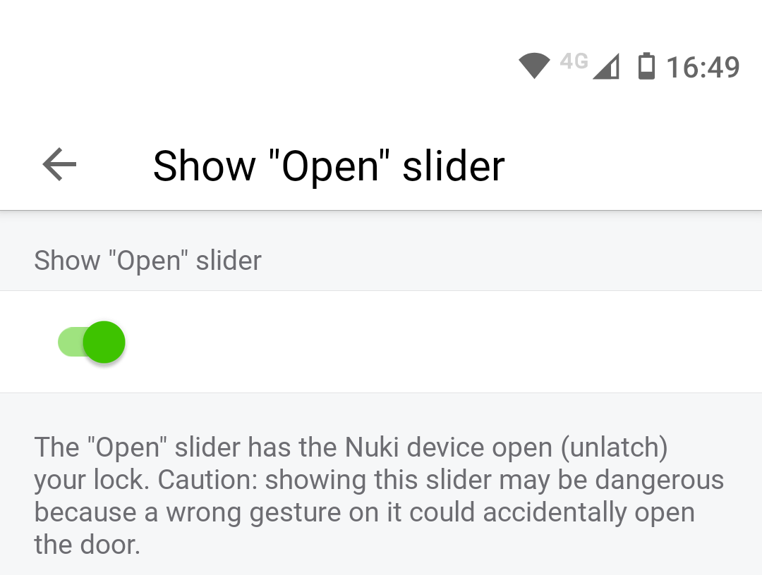

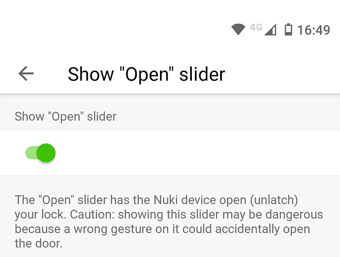

Hello @ChrisBoer and @2Be ,
I made an attempt to reintroduce the ability to unlatch a Smart Lock (or an Opener) directly from the Homey app user interface.
This capability is optional and can be disabled in the “Advanced Settings” of the device.
 ![Screenshot_20200911-164947](https://us1.discourse-cdn.com/flex025/uploads/athom/original/3X/d/b/db015520390bb3a7650df78a570222225a1518cf.png)
When the setting is enabled, Nuki Direct shows a slider (to be swiped up) in order to reduce the chance of a wrong tap.
 ![Swipe](https://us1.discourse-cdn.com/flex025/uploads/athom/original/3X/a/e/aeaa6d5ce41e838f5a13f2fd6a0dba5b3c79776c.jpeg)
The code of the the app avoid overlapped actions on the slider.
I committed the code to the “master” branch of the GitHub repository.

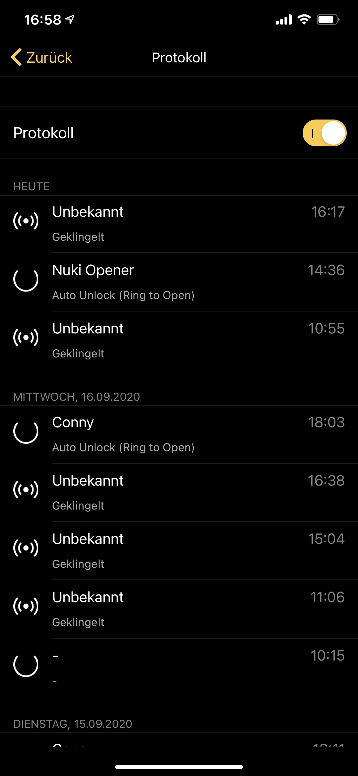

**Author:** ![DirkG](https://sea1.discourse-cdn.com/flex025/user_avatar/community.homey.app/dirkg/32/118897_2.png) [@DirkG](https://community.homey.app/u/DirkG)\
**Post date:** [September 17, 2020, 3:12pm UTC](https://community.homey.app/t/app-pro-nuki-direct/10853/140 "2020-09-17T15:12:47Z")
</div>
Hello @Piero_F,
what does it mean that the Opener is locked (Verriegelt)? And what triggers this action? I currently have no flow where the opener is used.
The action “Opener locked” (Verriegelt) is only shown in Homey and not in the Nuki App?
 ![image](https://us1.discourse-cdn.com/flex025/uploads/athom/original/3X/7/7/774b0a3b0c46832a3192826c5e7595665361619c.jpeg) ![image](https://us1.discourse-cdn.com/flex025/uploads/athom/original/3X/b/9/b9ed41a35c76e9776d4d7ee71a5de632aebb4115.jpeg)
<div class="post-metadata">
**Author:** ![Piero\_F](https://sea1.discourse-cdn.com/flex025/user_avatar/community.homey.app/piero_f/32/22759_2.png) [@Piero\_F](https://community.homey.app/u/Piero_F)\
**Post date:** [September 17, 2020, 4:18pm UTC](https://community.homey.app/t/app-pro-nuki-direct/10853/141 "2020-09-17T16:18:42Z")
</div>
Hello @DirkG,
An Opener is locked if `Continuous mode` (auf Deutsch: `Dauermodus`) is deactivated and the state of the Opener is `online`. If Continuous mode is active and/or the state is Ring to Open, the Opener becomes unlocked.
Continuous mode and Opener state may be changed in several ways, not necessarily by a flow card action.
The “lock/unlock” paradigm is a Homey model for all lock-class devices whereas Nuki has specific states and actions for its Opener. They cannot match perfectly…
