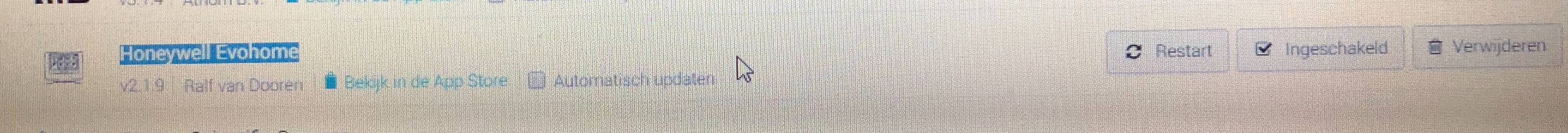

Do not see diagnostics report under apps.
System does show “send log” but that seems to be for Athom employees (gives a code that must be send to the employee)

I think you need to press the CTRL button and then hover over the app’s name. Then you’ll get an option to send a diagnostics report. It is a bit hidden.

It was the ALT button that shows the hidden option
Report is sent

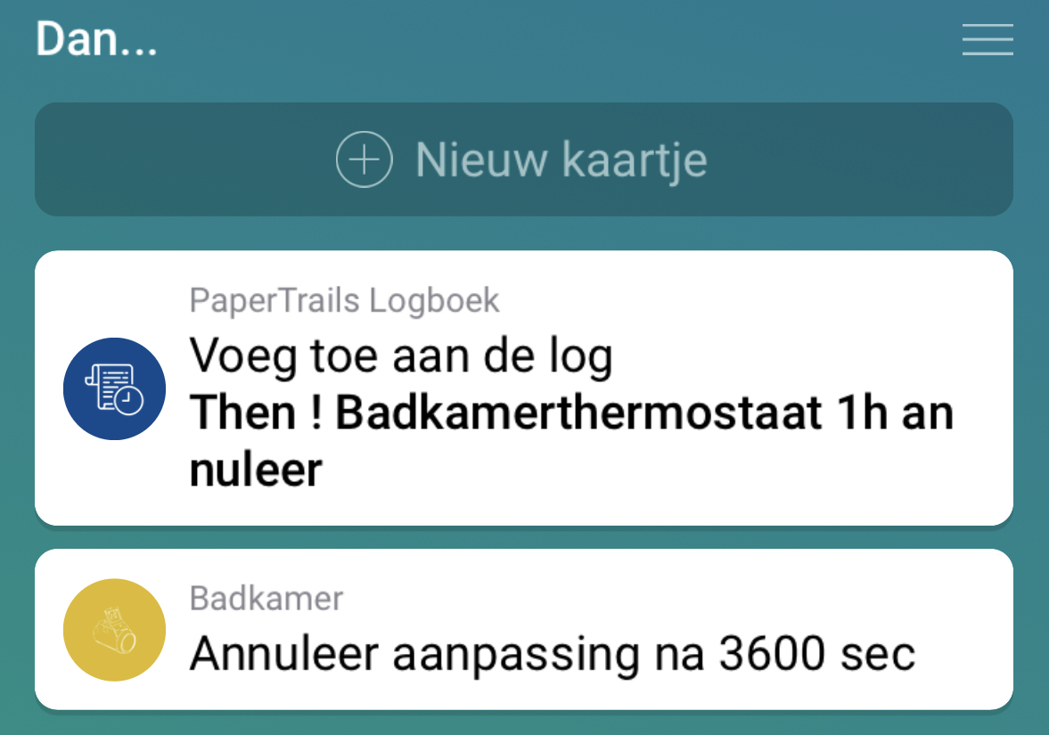

I could use some help on the honeywell app
Goal: detect when the temperature setting is changed manually. Then cancel it after an hour
I started with this
 ![image](https://us1.discourse-cdn.com/flex025/uploads/athom/original/3X/0/5/05bea9bed038baa5368934ab0e8f86eb23c9dd6b.jpeg) ![image](https://us1.discourse-cdn.com/flex025/uploads/athom/original/3X/8/9/89001eea2b255dd49c34150aa83f01fa4b761a9b.jpeg)
But the papertrails logging shows the flow is also triggered when evohome is changing the temp setting (programmed)
How can I make the flow detect manual overrides?
I could add time limitations in the flow. But that creates a dependency to the evohome programming (when I change the evohome program I need to update my flows too)
Any suggestions?

In my personal experience, a manual override cannot be undone through a flow.
In our case we often turn on the heating manually in the bathroom when getting the bathtub ready to be filled with water. But we occasionally forget to turn it off again.
I have flows in place that detect this and instruct Evohome to turn of the heating in the bathroom.
I believe I’ve read this somewhere in the Evohome manuals or something that this is intended behavior: manual control is supposed to override programmatic controls.
Personally my plan is to stop using that manual control and have some flow in Homey set the temperature in the bathroom to a predefined level and then have it turn off again too, which _should_ work.
Let us know what your personal experience is and whether you can confirm my experience or disprove it.
Good luck!

> [@Joost\_Schevers](#):
It can by setting custom action to auto again:
 ![image](https://us1.discourse-cdn.com/flex025/uploads/athom/original/3X/3/8/3834217a862051df639b85c18428d5e5c7527582.jpeg)
Although it will reset all manual overrides (but how big is the chnce of having multiple ones active)
My issue is how to detect a manual override.
