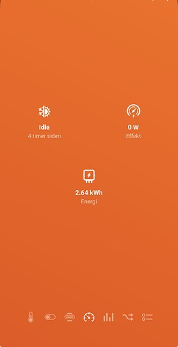

Well it is not the color that is the problem , it is when the color shows.
It shows orange even when the thermostat’s relay is off .
Because color changes ,only by thermostats setpoint/measures temp difference not when actually heating.
my ctm lyng thermostats seems to operate correctly
Picture shows heatit thermostat that have been idle for 4hours , still shows orange color
As I said, we have no control over the color, it is just based on the setpoint compared to the measured temperature.
Our thermostats have hysteresis and a regulation algorithm which makes it so even if the setpoint is higher than the measured temperature, it is not necessarily going to be heating.
