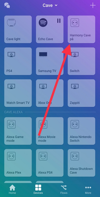

Come to think of a workaround today and after some config it works. It works fine but it’s still a workaround so I really hope that @jreenen will come back to us and have a look at the issue.
The workaround involves virtual switches, some new flows and IFTTT for Alexa control…
1. Removed the two PowerOff activities from the two rooms where I have my Harmony Hubs.
They keept messing up the avtivity starts and stopped in the flows and are not nessessary since they are the once cauing the problem.
2. Created a virtual switch for each Harmony Hub called “Harmony [room name] on”.
3. Created a flow for turning the virtual switch on when an activity is started for each room.
Put a Logic value with the Hub name in to prevent the other Hub to activate the virtual switch in this room and vice versa.
4. Created a flow for turning the virtual switch off when an activity is ended.
With the “virtual switch turn off” I can trigger other flows that I wanted to use the Homey Harmony App but cant because of the bug. Ex. turn on the ceiling light for 2 minutes so that I have time to gather my stuff and leave my “cave”. 🙂
 ![caveturnedoff](https://us1.discourse-cdn.com/flex025/uploads/athom/original/2X/f/fa7100d5dca94cb565cdf424ccddce1159b52076.jpeg)
Also, since I mostly control my Harmonys with Alexa I created an IFTTT trigger in a flow that trigger the Harmony in that room to activate the PowerOff activity for that Hub. IFTTT don’t have the bug that run the PowerOff on both or none of the Hubs, when one PowerOff is suppose to run. Works very well.
 ![cave_ifttt](https://us1.discourse-cdn.com/flex025/uploads/athom/original/2X/5/5987531f59b14fccca34fe509086a74c27830235.png)
The other Hub is in my living room and have similar setup with the names of that room and activities.
Sorry for the long and a little messy post. Please, let me know if you have better more simple solutions or any other feedback.
