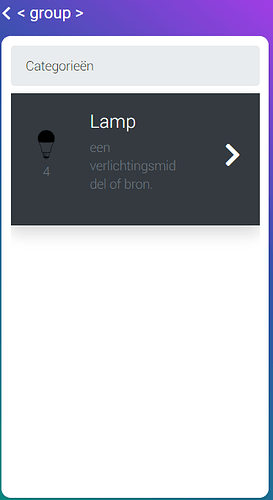

Within the group app you mean? they’re as far as i know, showing as lights. See screenshots below, if you meant something else please let me know 🙂

Sorry I mean the actual devices themselves with in the Athom Homey App.
You turn off the group, and the lights physically turn off - but do they (ZITHOEK1, ZITHOEK2, ZITHOEK3) show as ‘off’ in Homey?
