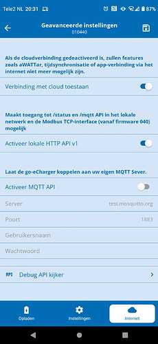

V2 device is Home+ with API-V1, your device has blue accents, where as V3 and V4 devices are Gemini with API-V2.
To be sure, check your mobile app from Internet / Advanced settings, you should see, if API V2 is available to be enabled. `Allow local HTTP API v2`
 ![image](https://us1.discourse-cdn.com/flex025/uploads/athom/original/3X/7/1/71939c9a144752656f8f9ad313175381f63c37e0.jpeg)
